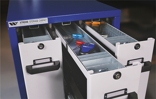

Placing tool storage near the brakes decreases setup times. |

A simple solution: Place cabinets with the right tools near the corresponding press brake. Placing tool storage near the brakes decreases setup times. It also lessens worker frustration and fatigue. The same is true of clearly identified tools. Identify tools using color coding by machine or cell with paint and laser-marking tools for details such as material number, radius or V-die opening, length, and tonnage capacity. When identifying tools, label the outsides and insides of cabinets or tool racks.
