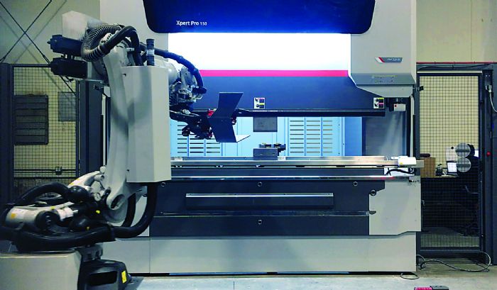

Bystronic-Kuka-Louis-Industries-press-brake-cell-track-reference table“We have the robot mounted on a track, with the brake set on a pedestal that makes it taller and easier to move parts from the robot to the brake,” he explains.

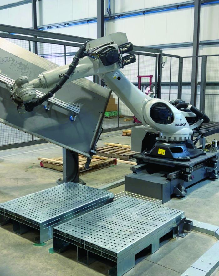

For accurate palletizing of parts and blanks, pallets with grid patterns and holes for locating pins rest on one side of the cell. Operators place pins in designated holes for proper part and blank stacking.
“We use those pin pallets for smaller-sized parts,” Louis explains.
Larger parts—“we produce a fair number of 8- or 10-ft.-long parts,” he says—lay ready in a set-down area in the cell opposite of the press brake. The robot picks these large-part sheets and sets them in a reference table to provide an edge location and orientation for the robot end-of-arm grippers. Then, the robot picks the sheets and places them in the brake. Backgauge sensors confirm proper positioning in the press brake, with hydraulic action triggered once the backgauge sensors give the okay.
