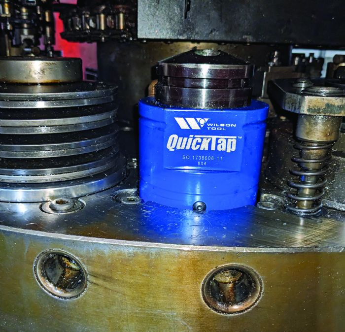

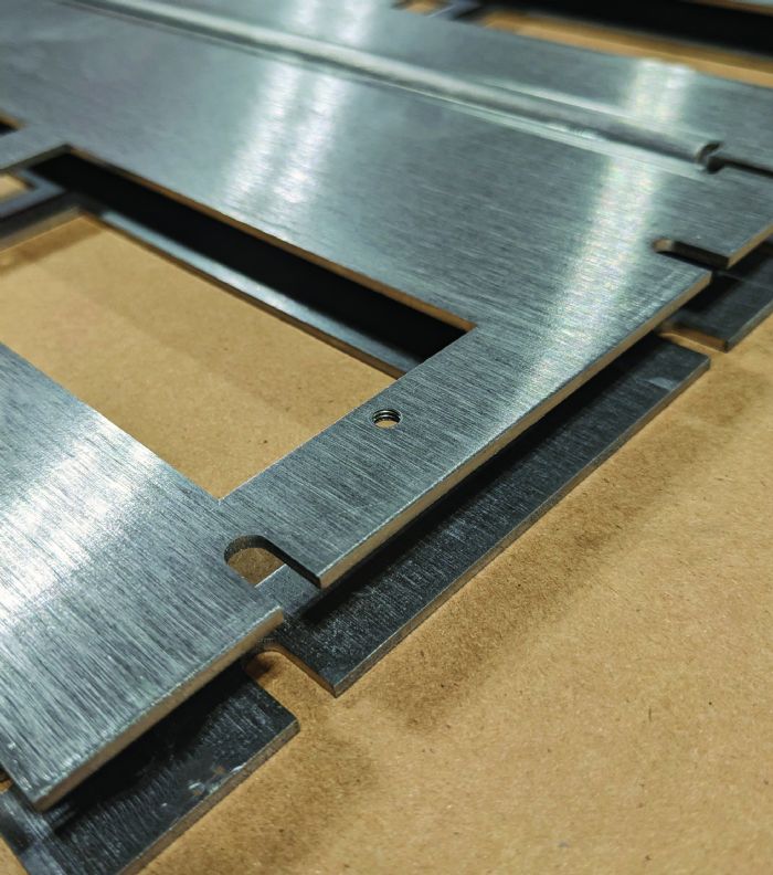

“Since launching the job, we’ve made nearly 400,000 tapped holes—that would have been an unwieldy amount of secondary operations, creating tremendous material-handling challenges throughout our shop.”
He also notes that the tapping tool forms the threads—“it’s not a cutting tool,” McDonald stresses, “so we don’t get material shavings in the machine or burrs pushing out of the backside of the parts.”
And, according to Wilson Tool officials, thread-forming taps create 30%-stronger tapped holes when compared to conventional cutting taps.
“The tapping tool is really a ‘machine within a machine,’” explains Wilson Tool sales engineer Hector Velazquez. “The user specifies the screw pitch required, and the hole sizes, then purchases the appropriate pitch insert that installs in the tapping tool, as well as the tap sizes that fit the specified pitch. The tapping tool has its own lubrication setup—an external lube tank and fluid-injection system that sends lubricant to the tapping tool with every stroke of the turret press. A full lube tank should last for about 40,000 taps.”
Amada EM2510NTIn the case of Precision Machine, “we’re using just one combination of pitch insert and tapping tool,” McDonald says. “All of the holes, so far, have been 10-32. We’re tapping at about 150 holes/min., and each insert is good for around 2500 holes before we have to change tips.”
Velazquez imparts one piece of advice for shops interested in adding the QuickTap tool to their libraries: “The tool requires attention to maintenance and upkeep. Users, in addition to checking the lube tank and ensuring that there’s always fluid available, must maintain a clean workspace, as the tapping mechanism can be sensitive to dirt and dust. It requires clean oil and clear fluid hoses—basic stuff. But the payoff when using the technology to eliminate tapping as a secondary operation is significant. Shops avoid the added costs associated with secondary ops—wait time, movement of materials, etc., and sidestep what can become significant production bottlenecks, enabling them to deliver shorter lead times for customers.”

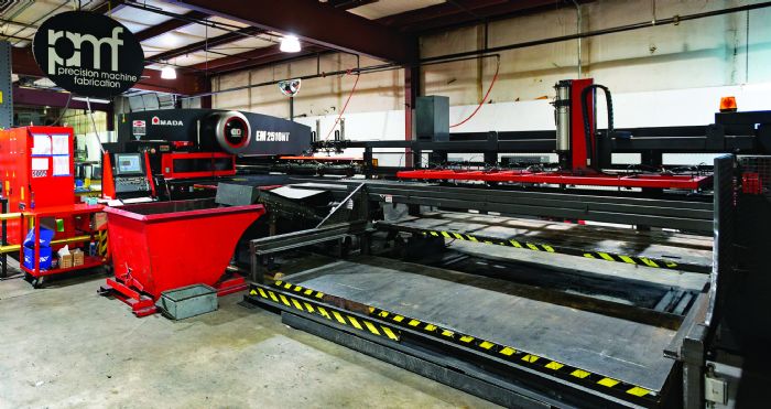

Per Amada, the EM2510NT boasts an AC servo-direct twin-drive system that delivers a maximum 500 hits/min. on 1-in. centers. Its 100-in.-X-axis table enables processing of 8-ft. sheets without repositioning. And, its 0.984-in. turret feed clearance enables forming to nearly a 1-in. flange. To the tooling experts at Wilson Tool, the application at Precision Machine Fabrication represents well the versatility of CNC turret presses, capabilities often not well understood among sheet metal fabricators.
