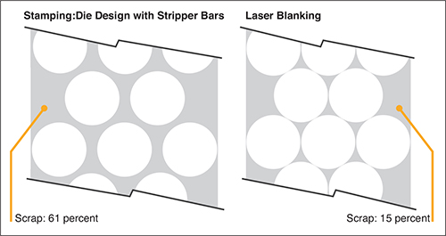

People tend to think of laser blanking as a niche manufacturing methodology or prototyping resource, and mechanical stamping as a process better suited for high-throughput environments. However, a multitude of factors determine what makes a successful manufacturing operation. These factors include customer responsiveness, product quality, efficiency, flexibility, maintenance and scrap reduction, material-yield improvement, overall cost reduction, and profitability. Given the advances in laser technology, manufacturers may find, in many cases, that laser blanking offers a more economical option than stamping.

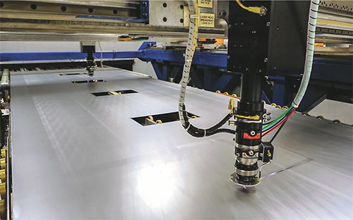

Laser cutting provides this ability. With no dedicated tooling, material can be ordered and programming accomplished in less than one day–sometimes in just a few hours. Import the part shapes into the CAD/CAM system, orient and nest them to maximize material usage, and send the program off to the machine for processing. Need a change? Just tweak the program.
Laser blanking produces a clean edge, regardless of the material being processed.
“We can change over from steel to aluminum or other material types,” says Kyle Adams, WSP plant manager. “The leveler can handle advanced high-strength material as hard as 1200 Mpa.”
The company’s blanking system achieves changeout times of 5 to 7 min. as compared to 30 to 35-min. changeovers for the company’s conventional blanking dies.

A laser-blanking line can accommodate multiple cutting heads (such as this two-laser setup) to speed cut time and increase productivity.
