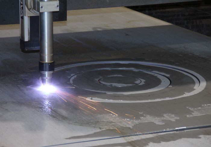

To bridge the gap, consider a conventional PAC system, which introduces dual-gas technology (one gas for the plasma gas and another for shielding), water-cooled torches and gas controls built into the system. Dual-gas systems constrict the arc more than single-gas systems, increase precision and deliver a cut width of about 0.095 in. when cutting 0.5-in.-thick steel at 100 A. They further enhance cut precision because post-cut grinding might not be necessary, as using oxygen as the plasma gas for cutting mild steel reduces nitride formation. The cut may well be weld-ready, but note that welding codes may specify mechanically finishing of the surface. Dual-gas systems also extend consumables life because torch components stay cooler and last longer.
High-precision plasma systems also use dual-gas technology, but the torch components constrict arc density and arc force to a much greater degree―think of the difference between the three cutting technologies as the precision between a butter knife, steak knife and surgical scalpel. A high-precision cut on 0.5-in.-thick steel at 100 A would yield a kerf of 0.091 in. and a cut accuracy of ±0.01 to 0.05 in. Parts can go straight to welding or the next fabrication step with little or no additional edge preparation because the cut will have a smooth cut surface with nearly vertical drag lines, a square cut face with a bevel angle of 0 to 3 deg., minimal top-edge rounding, little to no top spatter or bottom dross, no nitride contamination. and good mechanical properties in welded components.
High-precision systems also cut much faster than manual or conventional technology. For 0.25 in.-thick material, expect speeds to 150 in./min. on steel, 70 in./min. on stainless steel and 100 in./min. on aluminum. A human simply cannot move that quickly and maintain any degree of precision, much less maintain such a pace over an 8-hr. shift. While a high-precision power source costs about double that of a conventional system, the system can pay for itself in short order through achieving faster cutting speeds, harnessing the power of associated software (see below), eliminating post-cut edge preparation and lowering consumables cost. In fact, high-precision significantly lowers cut-cost per foot because the consumables last perhaps 2000 or more arc starts per set on 0.5-in.-thick mild steel, as compared to 1200 for conventional plasma and only a few hundred for air plasma.

Dual-gas systems offer the flexibility to use air, oxygen, nitrogen or argon/ helium as the plasma gas, and air or nitrogen as the shielding gas to improve cut quality, eliminate dross and, as noted, increase consumable life. The table on page 26 summarizes gas options and benefits. For cutting mild-steel parts to be welded or where good fit-up is important, most fabricators today elect to use high-precision systems with oxygen as the plasma gas. To evaluate cut costs, quality, speed and consumables life, PAC-system manufacturers can provide sample cuts.
For cutting nonferrous metals such as aluminum or stainless steel, consider the benefits of water mist secondary (WMS) technology, offered as an option with some PAC systems. This technology, which requires a specialized torch, uses nitrogen as the plasma gas and ordinary tap water as the shield gas. During cutting, the energy from the plasma gas divides the water in the torch into its principal components, hydrogen and oxygen. The hydrogen creates a reduced atmosphere in the cutting zone, isolating it from contaminating elements, and producing a clean, dross-free cut and nitride-free cut surface.
