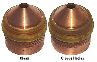

1) Keep the consumables clean (Figs. 1, 2).

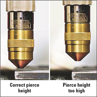

3) Verify proper piercing height (Fig. 3).
The time it takes for the plasma arc to pierce through the workpiece can be as long as 4.5 sec. During this time, the molten steel is being forced upward by the intense gas pressure. Piercing too close to the plate can damage or destroy a shield cap after as little as one pierce. Conversely, using a pierce height too far from the workpiece can cause a misfire, diminishing electrode life. Use the correct pierce height for the material thickness, as prescribed in the owner’s manual.

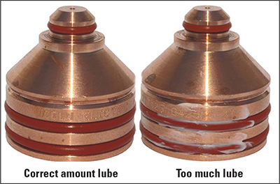

4) Don’t forget the o-ring lube (Fig. 4).

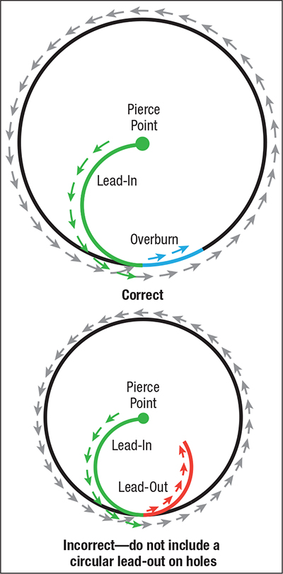

Use just enough lube to put a slight sheen on the o-rings. Too much lube will attract dirt and dust particles, while too little can result in a damaged o-ring. With a damaged o-ring, gas and coolant can mix inside the consumable chamber of the torch, reducing cut quality.5) Do not add a circular lead-out when cutting holes (Fig. 5).
Once the torch has completed cutting the perimeter of a hole, the leftover center slug will drop out. On holes with a lead-out, this happens before the plasma power supply can perform an orderly shutdown of the arc. The arc instantly snaps off when the cutting current loses its path to ground, resulting in a significant reduction in electrode life. Instead, use the nesting software to include a small amount of overburn to clean-up the hole.

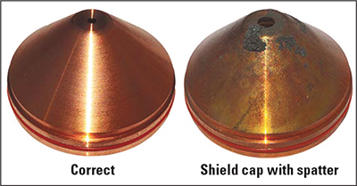

7) Remove material buildup from the shield cap (Fig. 6).
If the torch drops down from the set pierce height too soon, or inadvertently pierces too close to the workpiece, molten splatter can attach itself at or around the shield-cap orifice. Most times it can be removed easily using an abrasive hand pad (not sandpaper). If this spatter is not removed, it can lead to double-arcing, which can damage the electrode and nozzle.
