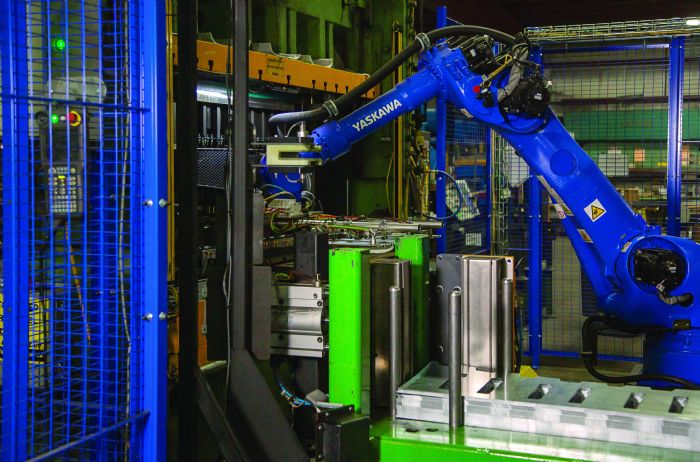

The result: A Yaskawa Model GP180 robot for automated press tending (the company also boasts metal stamping proficiency), replacing manual blank and part loading and unloading. Specifically, the robot destacks 20-guage steel blanks, using an embedded thickness gauge to confirm single-piece pickup, and places a blank in a 300-ton mechanical press housing a forming die. Following the press stroke, the robot removes the workpiece, now a tube section, and places it in a hydraulic press to produce a 12-in. bend. The 13.25-in.-long finished part is manually unloaded and pallet-stacked while the robot begins the cycle anew with blank destacking.
“This automates what had been three manual operations,” Sukup says, noting again that such automation frees personnel for other duties. “Cycle time saw a 30-percent improvement, but the real payback was going from three operators to one, allowing us to use the other two operators in other departments.”
The six-axis GP180 robot handles payloads to 180 kg, and offers a horizontal reach surpassing 2700 mm with a vertical reach of nearly 3400 mm. A streamlined robot upper arm eases access to parts in confined spaces, according to Yaskawa Motoman, while a wide wrist-motion range reduces interference with fixtures—this reduced interference design enables placement of the GP180 in close proximity of work zones, meaning less floorspace required in cell operations.
Dual-part specialty handling was designed through coordination with Motoman, with end-of-arm tooling developed to first handle blank placement, then rotate to place the formed piece for the final forming process.
