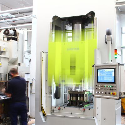

The job at hand: embossing flow channels into a 52-in.-dia. 16-gauge sheet of Inconel 625, which later gets seam-welded to an 11-gauge flat piece to fabricate a subassembly for the plate-style heat exchanger. To stamp the embossed plate with the takeover die, DMP partnered with press manufacturer Beckwood Press Co. to develop a custom 2500-ton hydraulic eight-point gib-guided press. It boasts a 48 by 66-in. working area, 40-ton stripping force, 14-in. stroke, 6-in. shut height and 20 in. of daylight. Among its features: a crown-mounted power system and reservoir, and a kidney-loop filter/cooler circuit with thermostatically controlled, electric fan-powered oil cooler. DMP commissioned the new press in September 2020.
“DMP reached out to us with a detailed part and tool already developed,” says Beckwood sales engineer Gerard Choinka, “and it provided a clear project scope and definition. Often, when customers come to us they’re clear on the part they need to make but unclear on tooling or press requirements. In those cases, we learn what we can about the part, process and production goals and, armed with forming simulations, we can develop the machine and automation to achieve the customer’s goals.
“In this case,” Choinka continues, “DMP already had a developed tool and process. We then were able to build and customize a press around that existing tool. Typically, with a press this size we prefer to use a gib-guidance system because it counteracts the effects of off-center loading during forming, and ensures that the press maintains precise bed-to-ram parallelism.”
“The previous press used to emboss these plates originally was used to make propellers for B-24 bombers,” Keith says. “It began to show its age and no longer could precisely and repeatedly maintain bolster and ram squareness. And, I think it was undersized for the job; we knew we needed more tonnage. The job requires dimensional tolerances as fine as 0.020 in., especially on the critical dimensions around the flow channels, and that required a new, high-quality press.”

…in the hydraulic press, says Keith, “include the amount of force applied and when it’s applied, and how quickly the force is applied. It takes about 3 min. to complete the deliberate and controlled forming process, with a ram approach speed of 118 in./min., forming speed of 16 in./min., and 114-in./min. return.
“We’re still refining the process,” Keith continues, “to ensure consistent results. Lubricant appears to be a critical success factor, and we’re still evaluating several options.”
Should he wish to adjust the forming-process parameters, Keith notes the user friendliness of the press’ Allen-Bradley PLC. And, he points to the Beckwood remote-support technology, called PressLink, integrated into the press control system and connected via a standard internet connection, as a nice “insurance policy,” should he need remote troubleshooting or programming support. MF
