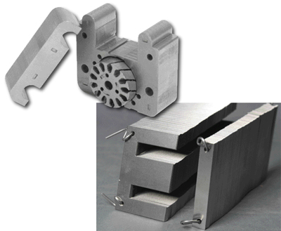

As for production, Orchid has not experienced any issues with its carbide tooling after more than two years of using the new lubricant, while application of lubricant has been reduced to where the lamination stampings exit the presses dry. This gives optimum results for the annealing process but makes it difficult for the stackers to wire the lamination stacks together. Now Orchid applies just enough lubricant to allow the laminations to stick together coming out of the die, making it easier for the stackers to insert the wires.
