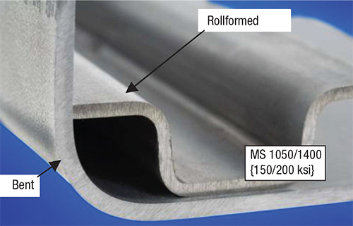

The rollforming process, used to initially harden the workpiece material, comprises a series of bending operations that start at the center of the blank and work outward. This allows early forming of the edge material to lock the sheetmetal, creating a stretch contribution. One benefit: The designed blank width is the sum of the neutral-axis widths. Therefore, the amount of material needed to form a complex design can be computed early in the deformation process.Fig. 1—Rollforming and bending of martensitic steel can have unexpected results. AHSS Application Guidelines—Ver. 4.1.
To illustrate this, we rollformed sheets of martensitic steel (MS 1050/1400) to their smallest radius (Fig. 1). The same MS steel also was bent to its smallest radius; rollforming generated the smallest radius.
