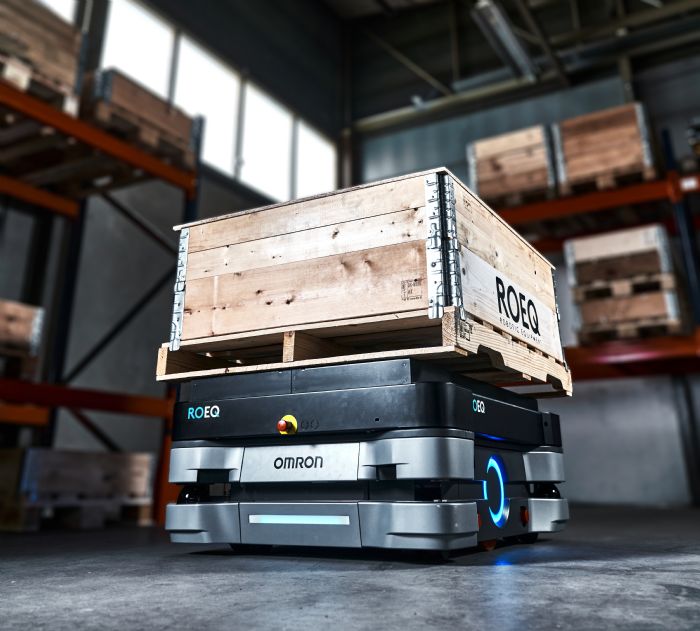

Omron-ROEQ-AMR-pallet-lifterThe flat-top TML500/TML750 Lifter enables MD-series AMRs to safely pick up, transport and drop off pallets and cargo weighing to 1120 lb. with the MD-650 and 1680 lb. with the MD-900. A new ROEQ PR750 Pallet Rack also is available with a space-saving Multi Rack option. And, an optional ROEQ Cargo Sensor Kit provides additional control to ensure that goods stay in place on the AMR. The lifter is available for both U.S. and Euro pallets.

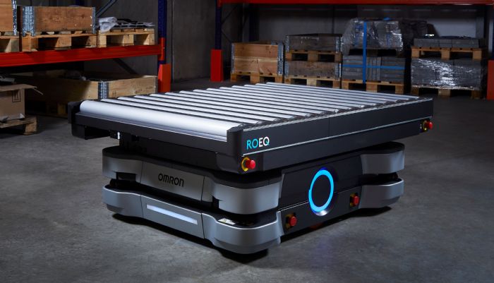

Omron-ROEQ-AMR-top-rollerThe heavy-duty TR600/TR700 Roller allows MD-series AMRs to pick up and deliver heavy goods, to 1490 lb.) between conveyor stations. The full solution includes the ROEQ GuardCom system, which provides additional safety and efficiency when transferring between the top roller and the receiving station, using robust sensor technology.
