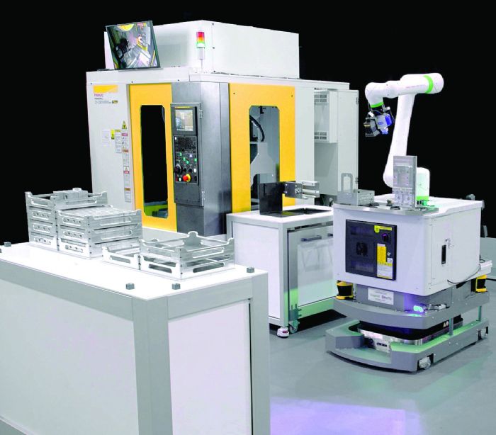

A CNC machine can communicate with a mobile manipulator in many ways. The demonstration described above attempted to mimic a human operator as much as possible, with vision employed for communication between the CNC and the rest of the cell.
As demonstrated, when the machine completes a cycle, it opens the door and uses the stack light to indicate that service is required. The mobile manipulator arrives at the machine and checks the light to confirm the service requirement. After completing tasks at the machine, the robot presses the cycle start button and checks the stack light a final time to verify that the machine is running before the manipulator leaves the station.
Another application might employ networked communication, potentially yielding a more efficient solution. In this case, the CNC machine can signal when a cycle is almost completed, with a mobile manipulator dispatched early so that it arrives just as the machine cycle completes.

The demonstrated mobile manipulator possesses numerous safety-rated features. The cobot itself is power- and force-limited, and the manipulator also employs laser scanners mounted on two corners, offering 360-deg. coverage. For low-risk tasks, the cobot provides safe operation without the need for safety scanners. To utilize higher speeds or perform riskier tasks, safety scanners can be used to prevent the arm from moving in proximity of human operators. The key here is flexibility—power- and force-limiting features of the cobot can be augmented by the area scanners to achieve a safe system in a way that makes sense for each unique application.
As for navigation, the Otto 100 AMR offers several advantages in transporting a mobile cobot/manipulator, including:
- Flexibility to respond to unexpected obstacles by automatically rerouting around obstructions
- Large wheels that allow the AMR to travel over rough or bumpy factory floors
- Straightforward route-map setup as only a single manual drive around the site sets the AMR’s map, with the map then populated with stations, chargers and other points of interest.
