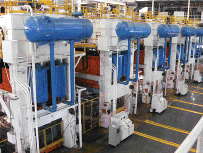

This five-press line at Estampados
Magna de Mexico produces Class A automotive panels. Originally set up
as a tandem line, it now runs more like a transfer line—more quickly
and smoothly than ever before—thanks to new automation added to the
line earlier this year. |

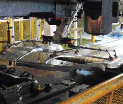

Among the products formed along the
newly automated tandem line are one-piece body sides, shown here, as
well as hoods, doors and floor pans. |
