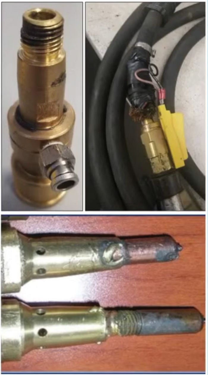

Welding-Miller-Bernard-Tregaskiss-wire-cable problems-timestamp820Be sure to keep up with maintenance. At the beginning of every shift, welders should inspect the gun handle to make sure it is not broken. A broken handle can lead to safety and performance issues. Ensure that all screws are tight; you don’t want them falling out during or after a welding job. Next check all connections—contact tips and diffusers. Throughout the life of the contact tip it will loosen, so it is important to tighten regularly.
The strain relief on the welding-torch cord is there for a reason. From time to time welders cut it off. Why? Perhaps for ergonomic reasons—to make the gun easier to hold. However, removing the strain relief comes with its own set of problems. When it’s removed, the plastic gun handle can cut through the cable and damage it, exposing bare wires. This is a huge no-no, especially as it’s located so closely to the welder’s hand.
However, it is more likely that removing the strain relief will cause a kink in the gas-flow tube located inside of the cable. The tube could become kinked and cut off the flow of the shielding gas, which causes porosity in the weld.
A welder may not recognize kinking as the cause, and waste time and effort searching for other causes of porosity. Even with the strain relief attached, be mindful of possible kinks in the cable that can impede gas flow and, again, introduce porosity. While gas problems most often cause porosity, a welder may choose to chase down other possibilities while a quick check of the cable can head off the problem right away.
Damaged power cables can lead to a gas leak or an open electrical circuit. This happens when the cable receives cuts, nicks or tears in the jacketing. Electrical tape is not a quick fix and OSHA will agree. Thick patches such as 600-V heat-shrink wrap will work, but will prevent bending of the repaired area of the cable, which can be a nuisance. We recommend a complete repair. Some welding manufacturers offer a fully repairable welding-gun setup where users can remove a bad cable section and reterminate the cable, but this will result in a shorter cable length.
Ensure Proper Install of Consumables
When installing consumables, ensure proper tightness. This does not mean only hand-tightening. Most often in the field poor consumables life is caused by loose tips. A loose connection causes electrical resistance, resulting in heat. This will cause melting of the diffuser and tip, and cause issues with the welding torch. Over time, torch tips will loosen due to heat cycling and the vibration of welding. Check tip tightness periodically to ensure that the tip stays tight, creating less chance of issues.
Check for tightness on cable connections to the welding-gun neck. And, don’t pull on the gun as a means to move feeders around, whether boom- or cart-mounted. The gun and cable are not designed to be a leash. Doing so may pull the copper out of its connection point and ruin the welding torch, leading either to a torch repair or replacement.

When is it time to change consumables? Prematurely changing consumables wastes time and money, whereas too late affects weld quality and productivity. One common issue related to consumable life is burnback—when the wire melts in the contact tip. Grinding the end of the tip off is not a quick fix. Instead, replace the tip. Grinding, particularly in industrial applications, likely will consume more time compared to replacement. Operating a grinder requires careful attention to safety protocols and the use of appropriate personal protective gear, and altering the distance between the tool tip and the workpiece can impact weld parameters.
When reaching the end of a tip lifecycle, keyholing or vaporization of the melt will occur. That’s a primary failure point. Wandering arc and other problems also indicate the need for tip replacement. Eventual tip failure is just the nature of the beast in welding. Premature tip failure, however, demands a closer look. Such failure may be caused by bad cast (diameter of the welding wire as it unspools), improper setup  parameters on the welding machine or improper wire-drive-reel tension. Addressing these problems will add life to the welding tip. MF
