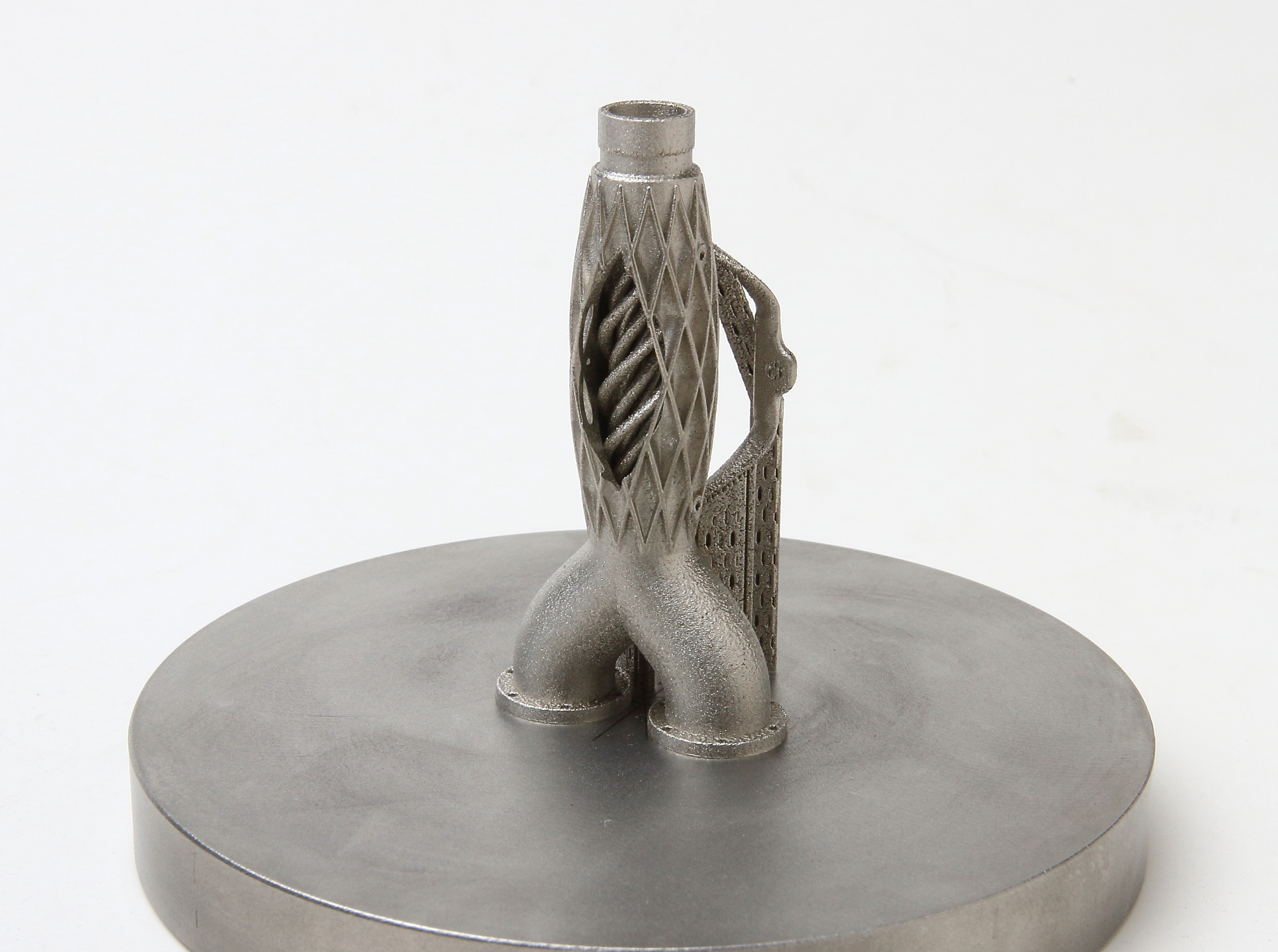

Tronix3D printed this pure-nickel heat exchanger, about 60 mm tall, with an inner coiling that maximizes efficiency by optimizing the surface area while adding the ideal properties of pure nickel for thermal conductivity. |
