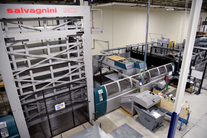

Feeding the new equipment: two 20-ft.-tall, 12-shelf towers, each capable of storing three tons of raw sheet, mostly 20-gauge. The towers’ strategic positioning with the fabricating equipment’s sequential configuration provides for a streamlined, time-saving fabrication line. The towers’ sheet metal inventory is conveyed automatically through the pre-programmed laser cutter, conveyance/part-manipulation system and panel-bending equipment—a distance of 120 linear ft.—without human handling. In fact, RenewAire now fabricates about 75 percent of all its parts without human handling—a striking fact when considering that only a year-and-a-half ago, the company fabricated no parts whatsoever.
The remaining 25 percent of parts—those demanding sophisticated techniques on the B3 press brake—require partial human handling. However, even that human intervention is lessened with RenewAire’s investment in a Salvagnini automated tool assistance (ATA) add-on that eliminates labor-intensive, hands-on B3 retooling setups.
