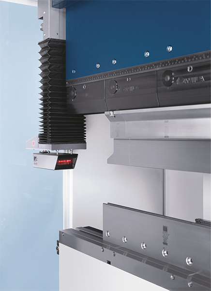

Point-of-contact guarding devices use a laser beam or array of beams, or a camera system to look at the area just in front of the punch as the ram travels up and down. These devices, working just ahead of the punch, guard a zone an inch or two ahead of the punch toward the operator, and then a distance below.
“Operators can walk up with a small part and bend with their hands within less than an inch of the die and still be protected,” says Ottens.
For example, notes Steve Lazinsky, president of Comeq, Inc., White Marsh, MD, laser-light security systems offer finger protection via a laser mounted on the top beam of a press brake, with a single laser beam located just below the top tool.
“This cost-effective system offers a comfortable working condition, with no limitation in holding the sheetmetal during bending,” Lazinsky says.
Point-of-contact guarding systems that include lasers and possibly cameras combine with foot-pedal and other switches and buttons via safety PLCs, which monitor all security-equipment connections. Dual-channel systems help ensure safety even if a single piece of multipronged safety equipment or a single signal fails.
This state-of-the-art safety technology takes advantage of advances in brake-stopping capability and control electronics, such as the safety PLCs, that enable the ram to stop immediately when the zone is breached. In addition, advances in light curtains and refinement of methods and guidelines for their use also have improved safety while enabling efficient production of certain parts. In fact, light curtains may be the best option for a setup that creates a pinch point at a relatively long distance from the ram.
