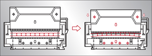

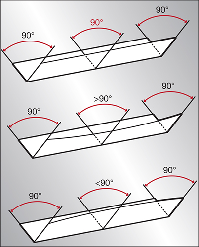

One of the unavoidable side effects of press-brake operation is frame deformation. We’re bending steel parts with other steel, that of the press brake, which for physical reasons will deflect. In particular, the ram will bow in the center (Fig. 1). At that point the punch will be farther away from the die, resulting in a wider angle and yielding a bent profile with a boat-like shape (Fig. 2). Even a small angle difference can turn metalforming into a process full of pitfalls.
frame deflection
Fig. 1—When press-brake bending, frame deflection will cause the ram to bow in the center. At that point the punch will be farther away from the die. This can mean trouble when attempting to keep parts within tolerance.

Bowing of the ram
Fig. 2—Bowing of the ram due to frame deflection results in a wider angle and yields a bent profile with a boat-like shape. Even a small angle difference can turn metalforming into a process full of pitfalls.

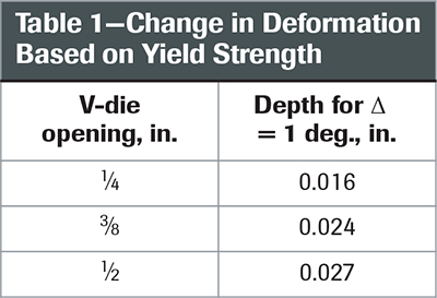

As a result, 41,000-psi steel still will be sold as A36, in spite of being 13 percent harder. The increased resistance will impart a higher force on the press brake, which will cause the ram to bow even more. For instance, switching from a 36,000- to a 41,000-psi steel will result in a deformation difference of roughly 0.002 in. in depth. Yet, this small curve causes a change of nearly 1 deg. in a 0.3-in. V-die (Table 1).
In other words, a thickness of less than that of a single sheet of paper (less than 0.04 in.) causes remarkable differences. Bear in mind that narrow openings such as these often are used to bend thin sheet for high-quality products.

Change in Deformation Based on Yield StrengthLabel data on the steel we buy, which may or may not be reliable in the first place, become completely worthless when we modify the sheet. Holes change strength along the bending line, whether the holes are produced via thermal cut or by drilling or milling. The same is true if the same piece has bends. In addition, punched holes introduce internal stresses that make it even more difficult to consider crowning as a fixed amount of deformation.

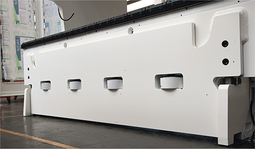

sensor in a press brake
To ensure quality parts, a press brake must compensate for frame deflection via accurate crowning. New technology can accomplish this. In one case, a sensor in the press-brake ram detects bowing. Cylinders in the table (pictured) raise the die accordingly, using sensors to match the height of the punch and die across the profile.
