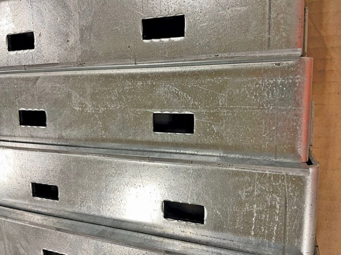

tool organizationWhile nibbling works, this process causes problems that negatively affect the machine and the workpiece, including:
  • Punching debris that damages turret bores
  • Increased production time due to numerous hits
  • Excessive tool wear that requires more frequent maintenance and replacement
  • Machine wear and tear
  • Rough or scalloped edges on the workpiece that require secondary operations.
“This last problem—post-punch rework—unfortunately is a common practice in fabrication shops,” Visser says, “but it doesn’t have to be. Fabricators can avoid this rework with a simple change in the punching process and a minor investment in tooling.”
The 80-Percent Rule
When it comes to punching part contours, “avoid nibbling at all costs,” Visser advises, while preaching what he calls the 80-percent rule of punching. That is, rather than nibbling contours, use a punching tool that, with each punching stroke, allows at least 80 percent of the punch face to seat over the workpiece.
“Any less than 80 percent will unevenly load the punch and lead to premature tool wear, burrs and shavings,” Visser says, “and you may start to pull slugs. During nibbling, you’ll seat 100 percent of the tool face on the first hit, then perform a series of punches where perhaps only 10 or 20 percent of the punch might seat on the material—not a best practice.”

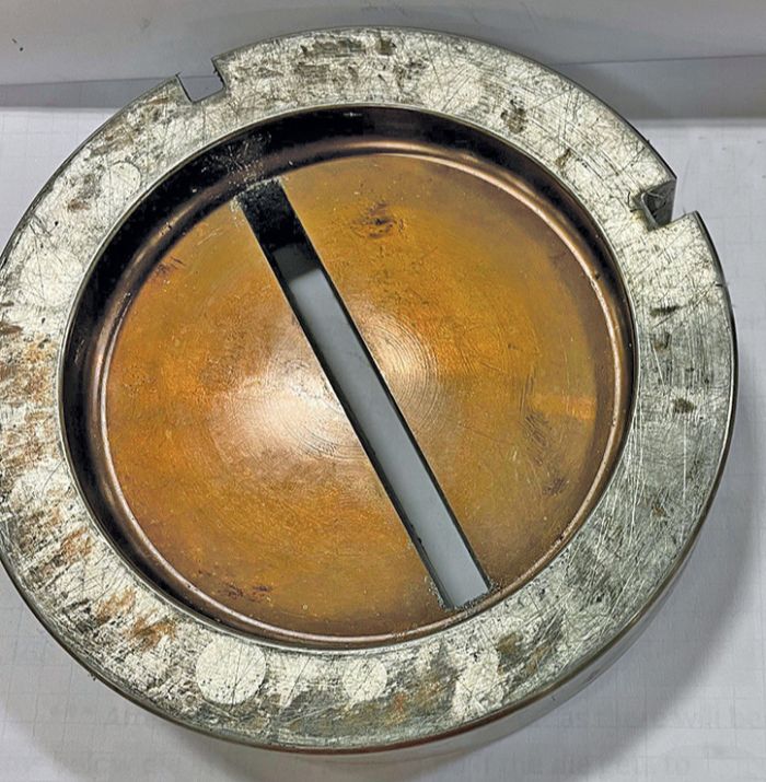

Visser has this piece of advice when it does come time to sharpen the tools: “Remember to replace the chamfer on the edge; a Scotch Brite wheel works well for this. Otherwise, the tool will scratch the underside of the sheets, potentially turning the entire sheet into scrap. I see this a lot. And, when you scratch the sheet, those shavings may wind up under the dies and in the tooling. This can cause damage to the die holder so that the die won’t sit flat, another cause of premature tool wear that easily can double consumable costs and increase machine downtime.” MF
