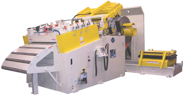

A heavy-duty straightener (shown) with seven 4-in. dia. work rolls located on 7-in. centers will straighten ¼-in.-thick cold-rolled steel, but will have minimal effect on 0.050-in. cold-rolled steel. Likewise, a straightener designed with seven 3-in.-dia. work rolls located on 5-in. centers will effectively straighten the 0.050-in.-thick steel but will lack the horsepower and roll strength to process ¼-in. material. |
