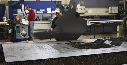

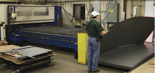

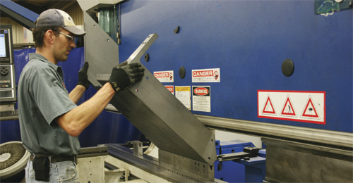

Top: An E.S. Metal operator tends to one of the firm’s two TruLaser 4030 laser-cutting machines, equipped with an 80- by 160-in. worktable and a 4000-W resonator. Shown is a part that the company manufactures for Trumpf; the laser makes quick work of the job, cutting 11 gauge (1⁄8 in.) pickled and oiled steel sheet at 150 in./min. Bottom: Cut parts are formed on a press brake, then welded.

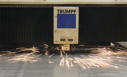

Among the latest capabilities present in state-of-the-art laser-cutting systems, according to Fickenscher:
• Closer monitoring of the piercing process to yield considerable time savings when processing thicker sheetmetal;
• Minimized axis movements, to boost throughput; and
• Automatic adjustment of beam focal length.
As a result of these and other innovations, here’s where fabricators are enjoying quality improvements:
• Surface roughness: 10 micrometers for sheetmetal 0.15 in. thick is the target for eliminating refinishing at visible edges.
• Perpendicularity: With proper adjustment, the deviation from a right angle can be limited to 0.004 in. in sheet 0.4 in. thick.
• Kerf width: While the width of the cut inevitably rises with increasing sheet thickness, it is a scant 0.006 in. for sheet about 0.10 in. thick.
• Groove deflection: Reducing the advancing speed can almost completely eliminate the groove trailing effect, even in thick sheet.
• Burr-free: Laser cutting eliminates burrs and thereby the additional step typically required to finish the edges, an important quality feature.
• Pitting: Just like erosion, pitting interrupts the regular cutting surface and can be avoided with the appropriate parameters.

The shop over the years has run several generations of CO2-laser-cutting machines, the latest of which are a pair of 4000-W machines. Both models are Trumpf TruLaser 4030 models that feature 80- by 160-in. worktables, and which, says Schleich, “cut 1-in. steel beautifully.”
