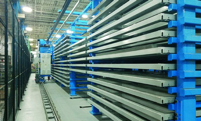

Buffering essentially means ensuring that each piece of automation equipment can handle the speed, physical capacity and production capability of each other piece as well as the laser cutting machine. This means matching the capacity and loading capability of a material-storage tower and load/unload automation to the speed and table size/processing area of a laser cutting machine, and matching all of that to any related denesting, picking and stacking automation, according to Plass. He notes that buffering forms a key part of Prima Power’s laser cutting-automation philosophy to ensure that automation products remain flexible to meet fabricators’ current and future needs.
