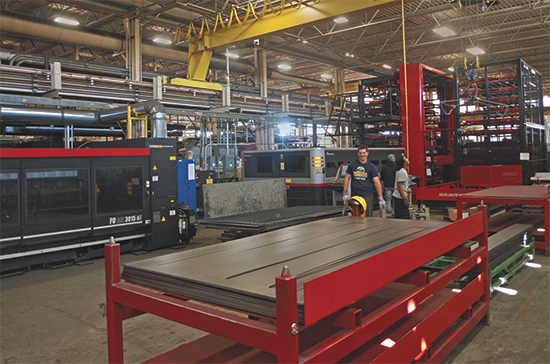

Two Amada ASLUL automatic load-unload systems (far right) deliver blanks to and receive nested, cut material from a 4-kW fiber-laser cutting machine at Advanta Industries. Move 130 ft. to the left (just out of frame) and you’ll find a single ASLUL system that automates material flow to and from an Amada CO2 laser-cutting machine. |

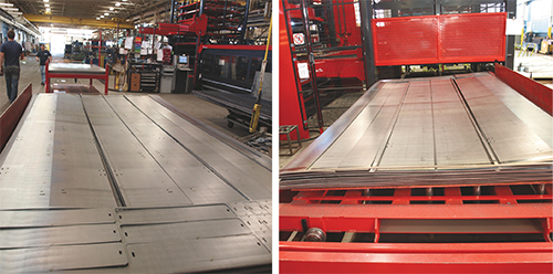

Along with improved accuracy and cut-edge quality—when comparing plasma to laser cutting—is the ability to common-line cut. “We do it all the time,” says Advanta production manager Rusty Obermyer. “With just this one sheet (right), common-line cutting saves more than 30 ft. of cutting.” |

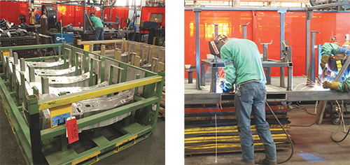

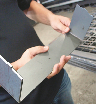

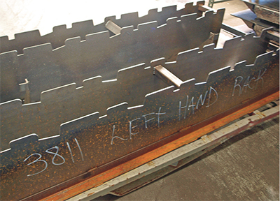

Laser cutting of tabs and slots in storage-rack components makes fitup and welding operations that much simpler for Advanta welders. Often, tabs and slots are uniquely sized so that there’s only one way parts can go together, error-proofing assembly operations. |
Precision to Obermyer and Grams means laser cutting of the sheet and plate components used to manufacture its products, as well as the components making up its precision weld fixtures—a huge part of its business. For Advanta, the mission is designing better racks that not only protect their precious cargo, but also allow customers to fit more parts into them. This allows customers to save significantly on freight costs over the life of a program.
The better the weld fixture the better the rack, and we spied some amazingly designed and built weld fixtures when touring the 130,000-sq.-ft. Advanta shop. Precision-laser-cut parts fit together beautifully in the fixtures to help welders assemble the racks. It’s clear that their jobs are made that much easier—meaning faster and with less chance for error—when weld fixtures are built from precision-laser-cut components.
The workhorse cutting machines at Advanta: an Amada FOM2 machine with a 4000-W CO2 laser, added in 2012; and an Amada FOL3015AJ machine with a 4000-W fiber laser, brought into the shop in 2013 direct from the FABTECH floor in Las Vegas. Automated material-handling systems manage material flow for both machines—twin storage towers (Amada ALSUL models) rack raw material and completed work at the fiber laser, and a single ALSUL tower manages material for and from the CO2 machine.

Advanta’s team of 23 skilled welders assemble laser-cut sheet, plate and tubular-steel products to fabricate returnable racks and other dunnage products, such as the racks shown here used to ship stamped automotive parts. |

An added benefit of bringing laser cutting inhouse is the extra opportunity for engineers and designers to find creative ways to leverage the technology to improve the fabrication processes. Case in point: Using the lasers to cut tabs and slots into rack components to make assembly more efficient and error-proof—in many cases, significantly more efficient.
“We can cut different sizes of tabs and slots in parts so that there is only one way to assemble,” says Obermyer. “That allows our welders to focus on what they do best—weld—and worry less about assembly and fitup. The parts fit together snugly with minimum joint gaps.”

Advanta runs both Amada machines unmanned for two shifts, and lights-out during a third shift. Longer-running jobs (often thicker plate) typically run lights-out. Each material-storage tower comprises nine shelves rated to 6600 lb. of material. The automated material-handling systems deliver nested blanks from the towers to the lasers, and return cut blanks back to the storage towers to be manually shaken apart later.
