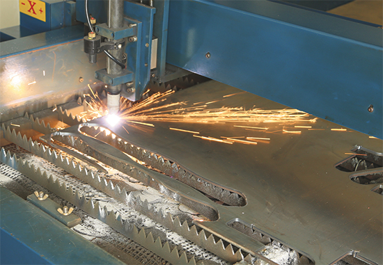

While Cornfield Customs largely dedicates its new PAC system to automated cutting on its new table, the arrangement allows Wagner to quickly switch to manual cutting, thanks to a quick-disconnect torch feature. This allows him to efficiently switch from the setup’s 180-deg. mechanized cutting torch to a 70- or 90-deg. manual torch. Software automatically detects which torch he has attached to switch between automatic and manual modes. This type of flexibility makes sense for Wagner, who often needs to manually cut one-off parts.

“I must be sure to dial-in all of the parameters—air pressure, travel speed, voltage and arc distance,” Wagner emphasizes. “Then I can adjust and fine-tune based on what the LEDs indicate. It’s very easy to deal with.”
Wagner was able to get his system up and running by following the manual, using his existing process knowledge along with some trial and error.

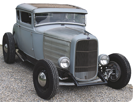

The bulk of Wagner’s plasma-cut parts include frame, chassis and suspension brackets and tabs for hot-rod assemblies including four-link rear suspensions, front-end mounts and motor-mount kits. The plasma-arc-cut parts shown here are from 3⁄16-in.-thick sheetmetal. |
