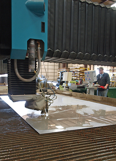

Wolfe’s new waterjet machine not only produces clean edges, it features Flow’s Dynamic Waterjet technology that does away with edge-taper concerns. The technology is based on mathematical modeling to predict taper angle, then compensating by adding the required wrist articulation. This action is managed by Flow’s FlowMaster Windows-based control system, based on user-input process parameters such as material type and thickness, cutting speed and desired angle quality. The cutting process, with edge-taper compensation, then occurs without intervention by a Wolfe programmer or operator. It pushes the taper to the scrap side of the workpiece to ensure a precise part-edge profile—four to six times more precise than a conventional waterjet, say Flow officials, with a much higher cutting speed.
“That’s critical to ensuring that we continue to meet lead-time requirements,” says Wolfe, “which of course have been tightening.”

“Before we added the second waterjet machine,” shares Alexander, “we often were forced, due to capacity constraints, to cut some of the stainless steel on our plasma-cutting machine and then drill any of the holes that were required. The secondary hole-drilling process diminished throughput, not to mention the need to sand off any edge discoloration from plasma cutting. That’s all become a thing of the past with the new waterjet machine.”

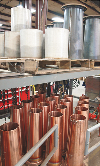

We saw several examples of the quality of the work coming off the new waterjet machine. Included were parts being cut from Type 304 stainless-steel sheets (5 by 10 ft.) for fabricating chutes and ductwork for a General Mills food-processing plant; and copper inserts for furnace nozzles, fabricated for a company that gas-atomizes metal powder.

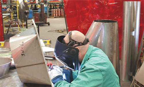

“When we were automotive-focused,” says Wolfe, “it often was difficult to differentiate ourselves from the several other shops around that can do that kind of work. Now, thanks in part to becoming experts in stainless-steel fabrication, we can make a name for ourselves and separate from the pack.” MF
