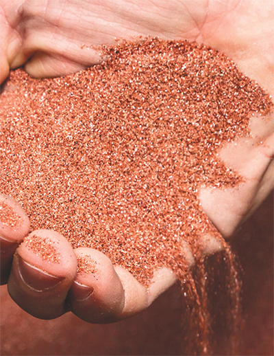

Fig. 4—To better combat unwanted taper, use the highest-quality abrasive available. And, experiment if necessary. If experiencing taper with an 80-mesh abrasive, try a 120- or 150-mesh. |

Use the highest-quality abrasive available. If experiencing taper with an 80-mesh abrasive, experiment with a 120- or 150-mesh. Lower-quality abrasives tend to have less-consistent particle sizes. In the end, this comes down to purchasing abrasive from a reputable distributor.
