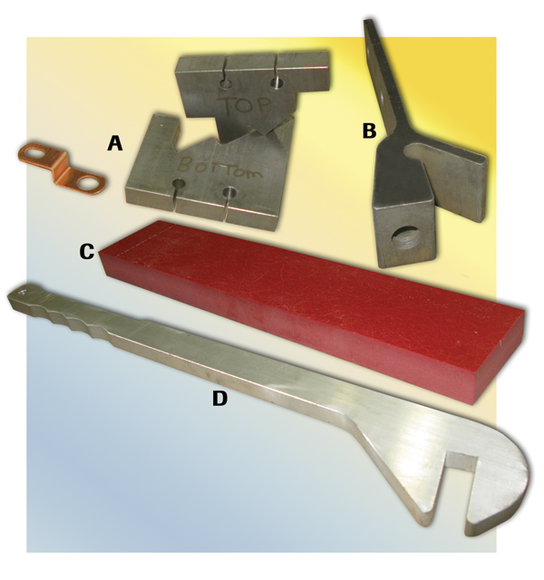

This sampling of parts cut by Twinco on its waterjet machine displays the machine’s broad range of capabilities.
A) A copper-alloy train-signal part waterjet-blanked from 1⁄6-in. sheet and formed in a stamping press; and the set of tools (of prehardened 4140 tool steel) used to form the copper part, also fabricated via waterjet cutting.
B) Twinco typically machines this part—a column clamp for elevator structures—from a casting. However, in this case, the flange is longer than usual and the order quantity was only 50, so Twinco waterjet-cut the part from 2-in. hot-rolled steel, then machined the holes.
C) The red plate is 2-in.-thick GPO 3 fiberglass-reinforced polyester.
D) Twinco waterjet-cut ¾-in.-thick aluminum plate to fabricate this wrench, used inhouse during testing of the train stops it manufactures.

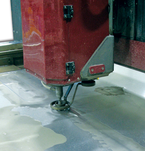

The Mitsubishi gantry-style cutting machine features linear-motor guides driven by brushless AC servo motors capable of rapid positioning speeds to 787 in./min., quite an upgrade from Twinco’s original belt-driven waterjet machine. Maximum workpiece size is 6 by 10 ft. Of Twinco’s diverse mix of workpiece materials, 75 percent of what it cuts on the waterjet machine is metallic, and half of that is stainless steel.

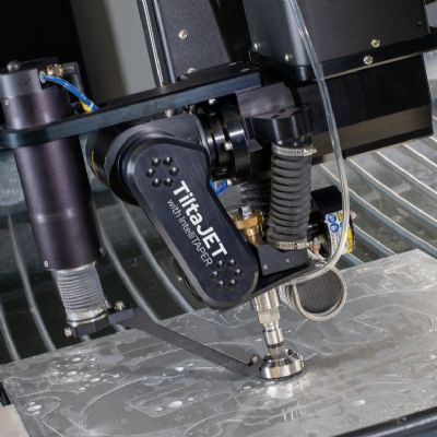

A key feature that drew Twinco to the Mitsubishi machine, according to the Schatzes, is its four-axis Intelligent Taper Control (ITC) feature. “We’re often expected to hold tolerances to ±0.001 to 0.002 in.,” says the elder Schatz, “and we rely on the machine’s ITC feature to make that possible.”
According to Mitsubishi, ITC provides 360-deg. taper control by adding a 1- to 2-deg. mechanical tilt to the cutting head. This tilt compensates for the waterjet widening as it exits the focus tube. The firm notes that this allows a wall-straightness tolerance of ±0.001 in. per ½-in. of workpiece thickness.
