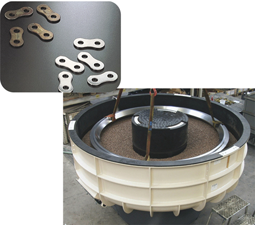

Figs. 1 and 2—Finishing of parts such as small chain links (above) requires only a small finishing machine, but large parts, such as bearing rings with diameters greater than 100 in. (right), require finishing in large rotary vibratory machines. |

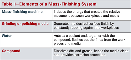

Yet for many, mass finishing remains a vibratory bowl filled with some “rocks.” Not true. It embodies a complex system with multiple elements that must be perfectly matched to each other (see Table 1). Only the ideal matchup of these elements guarantees ideal finishing results.

Workpiece size is especially important. For example, the deburring and edge-radiusing of small stampings, such as chain links (Fig. 1), can take place in a small, high-energy machine with a capacity of less than 1 cu. ft. On the other hand, the polishing of large wind-power gears weighing to 5 tons requires a significantly larger machine (Fig. 2) with capacities of well over 100 cu. ft.

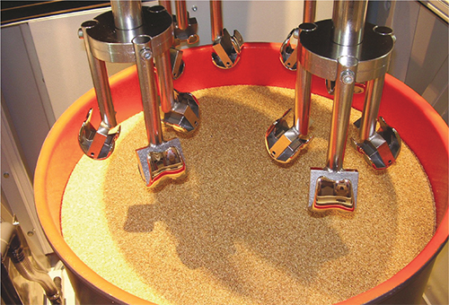

Fig. 3—Delicate parts, like the artificial knee joints shown here, must mount to fixtures to prevent scratches and nicks. |
Fragility of the workpieces is another important factor. With delicate, high-value workpieces, part-on-part contact must be avoided to prevent scratches or nicks (Fig. 3). Typically, these types of workpieces mount to a fixture that prevents any part-on-part contact during finishing.

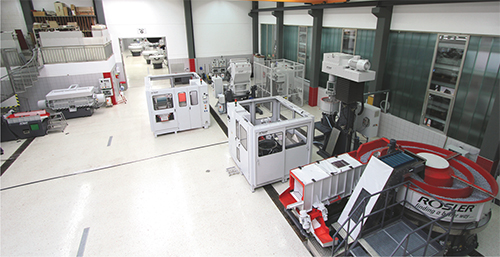

Fig. 4—All major mass-finishing-equipment suppliers maintain test labs, such as Rosler Metal Finishing USA’s lab in Battle Creek, MI (right), where they can run processing trials with a customer’s workpieces to develop the optimum finishing process and choose the right combinations of equipment and consumables. |
That’s why the choice of machine, media and compound should be left to the experts. All major mass-finishing-equipment suppliers maintain test labs where they can run processing trials with a customer’s workpieces to develop the optimum finishing process (Fig. 4), and choose the right equipment and consumables.
Considering the fact that mass finishing is highly empirical technology offering hundreds of equipment, media and compound combinations, it is not surprising that more than 95 percent of all equipment sales are preceded by processing trials at the equipment suppliers.

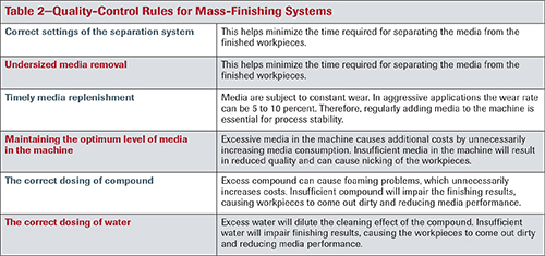

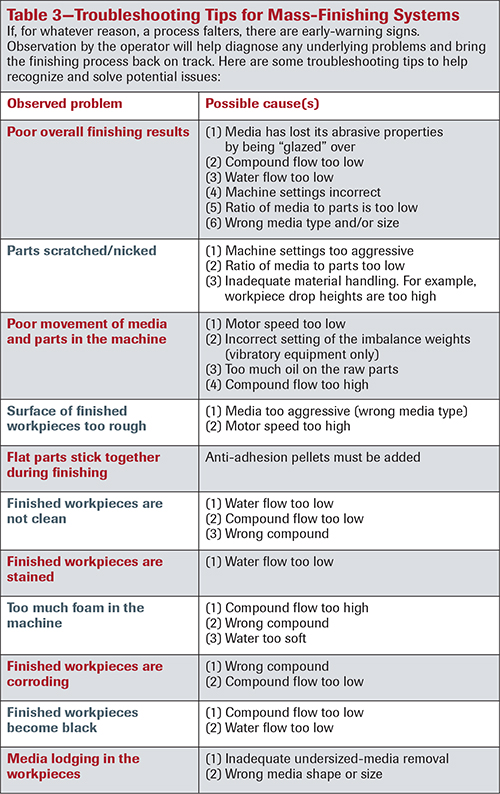

Once a mass-finishing process has been established with the selection of machine, media and compound, the system must be constantly monitored and, of course, properly maintained. By following a few simple quality-control rules (see Table 2), the process will remain stable, producing the desired finishing results. If needed, Table 3 offers helpful troubleshooting tips.
