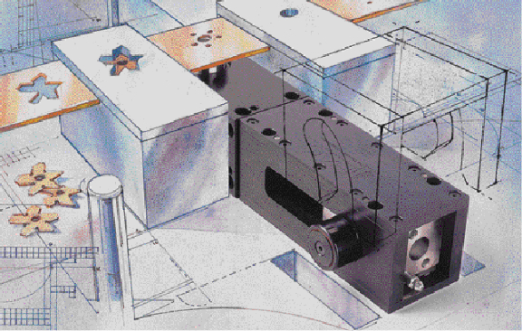

While in-die tapping (IDT) can offer phenomenal cost-saving opportunities for stampers, it continues to be one of the more intricate and perplexing operations occurring within stamping dies. Although IDT products have been commercially available for 20-plus years, only a small handful of designers and toolmakers have mastered the art. Add in the immense pressure to reduce overall design-and-build cost and the use of IDT can fall out due to corner-cutting. Furthermore, although CAD and CNC technology are magnificent resources, there’s still a certain amount of tool-making methodology and passion needed to ensure proficiency and success with IDT.
Anchor Danly in-die tapping lead photo Although it’s possible to drive an IDT application by several different auxiliary-power approaches, including servo-mechanical and hydraulic, here we’ll focus on mechanically driven IDT designs. The very same fundamentals and principles that apply to rock-solid die design, reliable die construction and trouble-free die operation also apply to attaining success (and handsome profits) with IDT. So, let this article serve to debunk the myth and mystery of IDT once and for all.

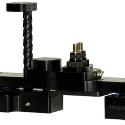

Most commercial IDT units employ direct-drive designs and thus use a preloaded mechanical spring as a motion-absorbing safety system to protect the tapping unit from damage in the event of a strip short-feed or a broken punch. If the workpiece contacts the tap before the start of the tapping cycle, premature wear can occur on the tap and also within the tap control cartridge or pitch insert. Further, the first thread produced in the part can become damaged due to the tap reverse-skidding against it during retraction as the misfeed spring unloads while the tap exits the hole.

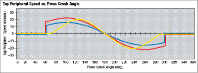

Watch the Speed Limit
Speed restrictions with IDT technology almost als result from the physical limitations of the taps, rather than the IDT units themselves. These limitations are mandated by the amount of friction-generated heat that can be tolerated by the tap’s base material and coating, and the lubricant being applied. So, the next time you’re hoping to go 60 strokes/min. in an M10 x 1.50 stainless-steel application, don’t blame your IDT supplier when it tells you it can’t be done.
Anchor Danly peripheral tap speeds fig. 5
Fig. 5—Graph illustrates peripheral tap speeds (while the tap is engaged in the material) for three different IDT alternatives for a stainless-steel application. Red and blue curves give speed profiles for direct-drive and external drivescrew IDT devices, while the yellow curve represents the speed profile for a cam-actuated internal drivescrew IDT device.
Fig. 5 shows peripheral tap speeds for three different IDT alternatives for a stainless-steel application. Each of the three curves represents the peripheral speed while the tap is engaged in the material. The red and blue curves give speed profiles for direct-drive and external drivescrew IDT devices, while the yellow curve represents the speed profile for a cam-actuated internal drivescrew IDT device. Because direct-drive designs generally do not disengage from the upper die shoe during operation, the tap moves continuously whenever the press operates. Thus, the tap has significant velocity when it’s trying to engage the hole.
By contrast, cam-actuated IDT devices are engaged and disengaged by the upper die shoe during the press cycle. The tap gradually accelerates from rest and exhibits a low velocity upon entry into the prehole—the single most critical moment in an IDT operation. In the case of the red curve, the peripheral speed of the tap upon entry is about 16 m/min. In the case of the blue curve, the peripheral speed is about 12 m/min. In the case of the yellow curve, the tap peripheral speed is very slow upon entry into the workpiece, which generally makes for more reliable engagement and reduced tap wear rates.

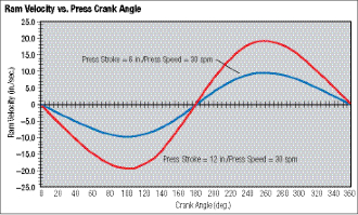

Anchor Danly press stroke fig. 6
Fig. 6—Choose the shortest press stroke available. The press stroke, of course, must be greater than the tapping stroke and must allow sufficient time for feeding and piloting.

  • Choose the shortest press stroke available. The press stroke, of course, must be greater than the tapping stroke and must allow sufficient time for feeding and piloting. A 12-in.-stroke press operating at 30 strokes/min. will exhibit double the ram velocity of a 6-in.-stroke press operating at 30 strokes/min. (Fig. 6).

Electronic Tapping Unit
