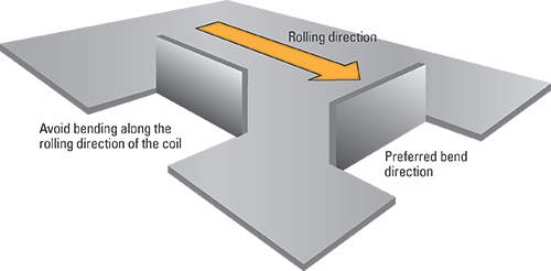

Many copper, brass, beryllium copper and nickel alloys used to produce small clips, electronic components and medical devices are produced from cold-rolled coil strip, automatically fed into progressive dies and high-speed stamping operations. The coil strip may be supplied in the annealed (dead soft) condition or a temper condition by cold working the strip prior to coiling.Cold-rolled strip typically will be more formable when bending perpendicular to the rolling direction as compared with bending along the rolling direction (see graphic). As the temper of the strip increases, so, too, does directionality. When creating a strip layout for a new part, the orientation of bending relative to the rolling direction of the coil is important because many dies are inadvertently designed with the part oriented so that bending occurs in the direction of less formability.
Coils procured in the full-annealed condition, or when the ratio of the inside bending radius to the strip thickness (R/t ratio) is relatively large, directionality may not be a problem. Conversely, when the product designer, process engineer or tooling engineer specifics a tight bending radii to control springback, the direction of bending can be critical.
