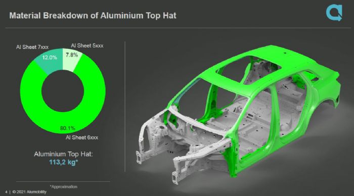

“The aluminum top hat developed for the study utilizes the latest forming and joining technology,” says Alumobility secretary general Mario Greco, who also serves as director of strategy, global automotive at Novelis, “to reduce the number of parts and joints, leading to significant weight savings while meeting or exceeding performance attributes for various load cases.”
Also investigated: the ability to marry the aluminum top hat to a steel underbody, “ensuring that we account for any added complexity and cost,” Greco says, “and understanding the real value created from the total solution.”

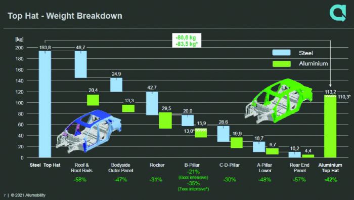

top hat weight reduction slide 7 from top hat studyCommenting on the top-hat study, Alumobility technical director Mark White, who worked for nearly 30 yr. in body design at Jaguar Land Rover (JLR) and with expertise in lightweight-vehicle technology and advanced body development, says:
“We compared a typical aluminum body to typical steel and mixed-material bodies and find that steel bodies have grown in complexity, combining a myriad of grades and coatings. In the end, a typical steel car has between 60 and 70 gauge/grade combinations. With a mixed-material design—one that includes aluminum and carbon fiber, for example—that complexity increases to perhaps 80 to 90 different gauge/grade combinations.
“With aluminum-intensive vehicles, such as the Ford F150 or some JLR models,” White continues, “we see only 20 to 30 gauge/grade combinations, and we don’t need additional protective coatings because aluminum self-heals. This lack of complexity is music to the ears of many OEM manufacturing engineers.”
In another study, Alumobility has investigated developing an aluminum B pillar, “testing our premise using a popular mass-produced electric vehicle (EV),” shares Greco. “We developed a high-strength 6XXX-series aluminum pillar to test side-by-side with the current steel solution.”
In both studies, significant weight savings were realized while meeting or exceeding performance attributes for various load cases and reducing the total number of component parts and joints.

When automotive engineers talk aluminum, specific grades dominate the conversation:
  • 5000 series—Relatively low strength, says White, but fairly ductile and useful for auto-body closures.
  • 6000 series—Bake hardened and used for outer panels and structural cold-formed parts.
  • 7000 series—"Where we approach the limits for cold forming,” White shares, “and start to look at hot forming for high strength and more complex shapes with the best material utilization.”
