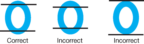

The tools used to create the circles on the flat sheet and measure the ellipses on the formed part contribute to measurement accuracy. The circles typically are applied by electrochemical etching, which requires using a stencil of the correct grid pattern. The width of the line that forms the boundary of each circle measures about 0.008 in. A translucent Mylar strip calibrated to measure the expansion percentage of each circle also contains lines (the diverging railroad tracks) measuring about 0.008 in. thick.
Ellipse measurements using calibrated Mylar strips must be made from the center-width position. The width difference between the ellipse circumference and the diverging ‘railroad tracks’ in this image is exaggerated for clarity—in reality, they are of similar dimension.
Accurate measurements require measurements from the center-width locations of the boundary line around the circumference of the ellipse. Inside-to-inside or outside-to-outside measurements are incorrect, as depicted in the figure, with an exaggerated difference in line thickness.
In the example targeting a 20-percent critical major-strain axis, measuring inside-to-inside (the middle example in the figure), the major strain axis reads as 0.112 in. (0.120 in. - 0.008 in.), which is +12 percent on the major-strain axis. Similarly, the minor-strain axis is measured as 0.092 in. (0.100 in. - 0.008 in.), which is -8 percent on the minor strain axis. On the other hand, a measurement of outside-to-outside dimensions (the righthand image in the figure), results in +28 percent on the major-strain axis and +8 percent on the minor axis.
In these examples, the boundary between the safe and marginal zone occurs at a data point of (+20 percent, 0 percent). Accurate measurements with an incorrect technique can lead to data points ranging from (+12 percent, -8 percent) to (+28 percent, +8 percent), and provides a false picture of the true situation.
