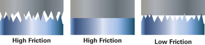

Tool surface-finish procedures also should change based on the chosen sheet-metal alloy. If the sheet and the tool have a high roughness, then the peak tips may break off as the sheet flows across the tool, leading to a high friction condition. High friction also exists with a low-roughness sheet and tool-steel combination, since the forming pressure squeezes out the lubricant between the surfaces. The ideal friction condition is when one surface has a relatively higher roughness compared with the other surface (see the accompanying illustration). However, the typical roughness of sheet aluminum and stainless-steel alloys is lower than that of plain-carbon steels. Aluminum also is softer than steel, so the roughness peaks may smear during forming. This results in particle buildup and an associated reduction in sheet metal flow.  The chosen sheet alloy should influence the tool surface finish to minimize this effect.
