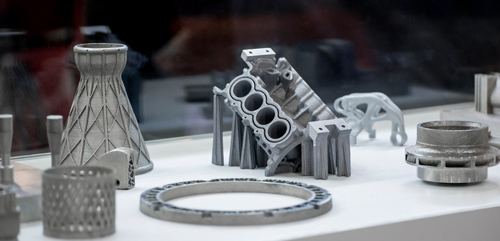

Optimizing metal powder via heat treatment can improve flowability to prevent clogging, thus speeding the process and producing a higher-quality part.
To eliminate porosity and enhance flowability, a growing number of powder suppliers and AM-machine manufacturers add a heat treatment step in the manufacturing process that involves tumble dryers to achieve a more consistent, high-quality product, says Paffendorf.
For example, APS utilizes advanced vacuum tumble dryers that provide sparging (gas injection) in addition to heat application. With this approach, a perforated tube positioned under the bed of material distributes a flow of inert gas, such as nitrogen, to help circulate heat evenly amid the powder.
“A raw metal powder may have particles with a porous, craggy outer surface,” says Paffendorf. “When we heat treat it in the tumble dryer, it closes up the pores to make the particle more spherical and flow more smoothly.”
