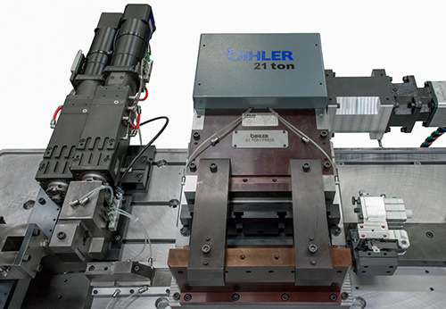

Today hundreds, potentially thousands, of traditional mechanical four-slide machines dating back to the 1960s (or earlier) still operate, and traditional slide forming remains an effective process for manufacturing small, intricate parts. Even so, there are limitations.
Modern four-slide forming equipment includes servo-driven systems.
For example, complex mechanical motions and timing sequences require setup technicians and operators to have more training and higher skill levels than necessary for a conventional press. Moreover, the setup process can be very time-consuming as it calls for the following:

The lack of modern controls and servo technologies restrict setup time, part complexity and production efficiency when using mechanical slide forming machines.
