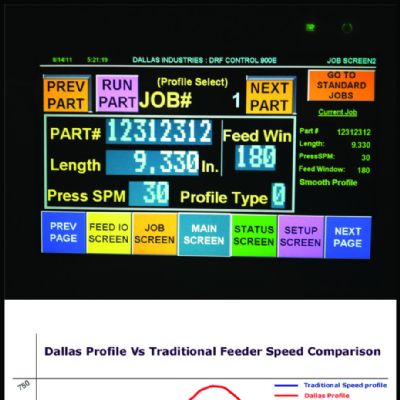

Dallas Industries, Troy, MI, will demonstrate its unique ProfileSelect feed control, explaining how it can minimize electrical and mechanical stress on stamping equipment and material. While typical press controls use a trapezoidal profile, which result in quick, jerky motions that have a chance of slipping and stressing the die and material, the ProfileSelect control uses a sinusoidal profile (cam motion). This provides a smooth motion and material feed while utilizing 100 percent of the press-feed window, putting less stress on all of the mechanics. ProfileSelect is suited for progressive-die work, when the part's cosmetics are a factor or when using delicate material. ProfileSelect controls have an HMI touchscreen and come standard on new Dallas press-feeding equipment. The control also can be retrofitted to most existing lines. Dallas also will showcase two of its servo press feeds connected to a networking, monitoring and analysis system for communicating to the plant floor while monitoring and analyzing equipment efficiencies and providing reports.
