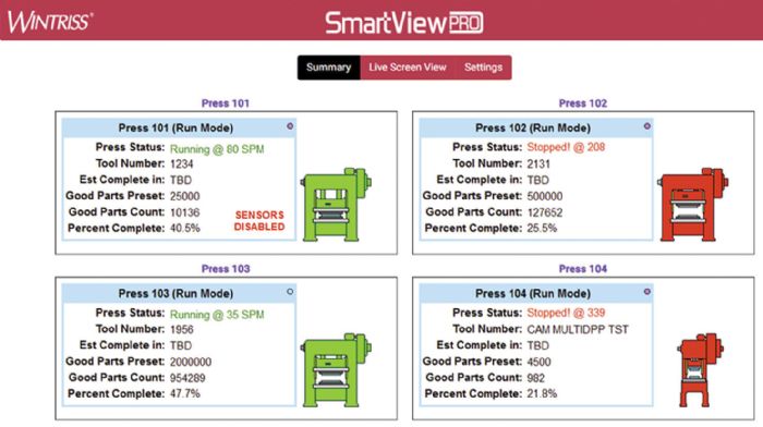

Wintriss Controls Group has introduced the SmartView Pro Network
Interface for its SmartPac Pro press automation controller. The new interface
allows any PC or mobile device on a network to access and download information
from networked SmartPac Pro controls.
The interface displays current job status, press tonnage, percent of job complete and estimated time until job completion. Users also can view SmartPac Pro error and event logs and send on-screen text messages to the press operator, saving time, enhancing productivity and reducing potential production problems. In addition, users can download an installed option list, tool list and individual tool programs.
