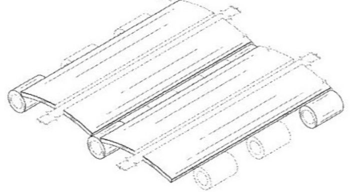

transcon-conveyor-patent-radius-plateTranscon Conveyor, Mentor, OH, has been awarded a United States Design Patent, #US D1,060,924 S, from the United States Patent and Trademark Office for its continuous-radius conveyor plates. As a conveyor belt travels around the belt sprockets at the conveyor discharge, the surface of a flat belt pan will chord in relation to a fixed point on that radius. This chording action creates a gap between the belt surface and that fixed point. When that fixed point is a table or chute for the carried part, the part may become trapped in that gap, which can jam the conveyor or damage the part. The continuous-radius plates solve this issue by keeping the gap to a minimum throughout the movement of the belting.
