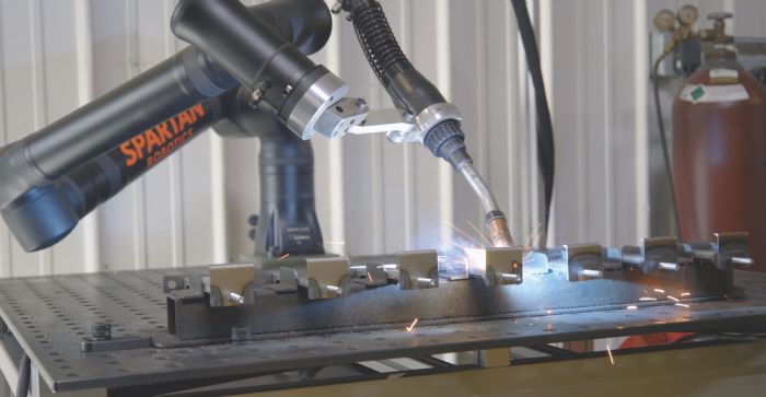

Kassow-welding-robot-teo-fabricationsNow the team finds that the seventh axis of its new cobot provides the dexterity needed to integrate seamlessly into tight spaces and automate repetitive welding tasks, all while working safely alongside human operators.

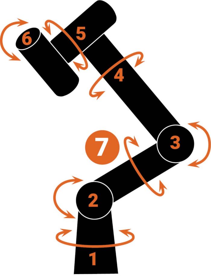

As described by Pierre de Giorgio, president of Spartan Robotics:
“The seventh axis acts as an elbow that rotates down like a human arm, increasing dexterity. That action greatly improves the cobot’s ability to reach into tight and difficult-to-reach weld joints and perform more work within the same work envelope than a traditional six-axis robot.”
Included in Teo’s weld cell is a Fronius 400-A arc-welding power supply, which also boasts some unique characteristics. Among them: a touchscreen display with menu navigation available in multiple languages; and embedded technology designed to stabilize weld penetration and arc length. Teo finds that the power supply minimizes spatter and produces high-quality welds.
The cobot tends to weldments fixtured on a 4 by 4-ft. Siegmund tabletop, fabricated from plasma-nitrided tool steel and surface-hardened for durability and wear resistance.
