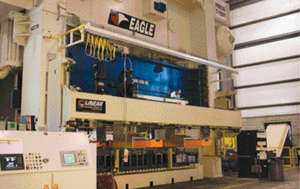

A servo-transfer system mounted on this 250-ton gap-frame press automates stamping of deep-drawn components.

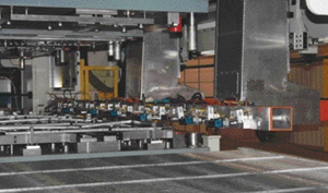

When it comes to designing and developing end-of-arm finger tooling, failure to appreciate the importance of this task and the attention to detail required can cause a stamper to pay the price in run rate, equipment downtime and startup time. Some stampings can easily be transferred at high rates using simple and inexpensive shovel-style tooling. Other parts require the use of pneumatic grippers or magnets to stabilize the part when transferring at high rates. Automation such as servo rotation, part ejection, lateral rotation and linear motion can be added to the transfer rails to manipulate the part, which helps the die designer simplify die design and achieve higher run rates. Tooling with quick-release mechanisms will expedite die changes.
Common methods for mounting end-of-arm tooling:
- Fixed tooling—the bars and fingers are changed out and stored on a rack near the press or with the die.
- Receivers placed in incremental locations on the bars where the end effectors are inserted. This setup is most common on large transfer presses with rolling bolsters and two sets of bars, and offers advantages when running a large number of parts and where minimum die-change times are required.
- A common plate located on the bars that includes several fixed finger stations. These plates typically store on racks located near the press.
