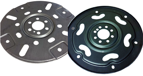

Runout and Offsets Critical Quality Concerns
The press operator assumes quality-control responsibilities, including piece-part inspection performed every 30 min. In addition to the previously noted dimensional tolerances, Harant adds that runout and offset tolerances are critical.

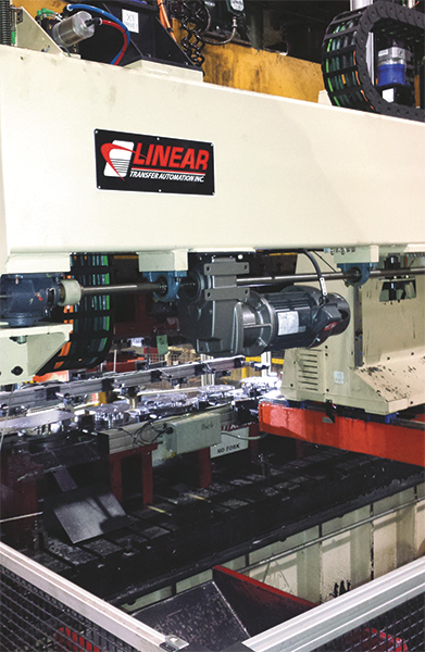

Also a focal point, early in the process-development stage, was tool development. “Forming clearances required extra attention,” Harant says, “to obtain the specified part diameter within the tolerance specifications. We went through three or four recuts of the form blocks and form rings on the first of the 10 dies, and then applied what we learned to the remaining dies to quicken their development.”
Harant also notes that J2340 steel alloys (340XF and 550XF) are “difficult to stamp. Shear strength is particularly high.”

See also: Linear Transfer Automation Inc.
