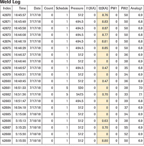

Weld Log
Low current values are displayed in the weld log.

  • Weld log (see Weld Log table). Creates a date and time stamp for every weld sequence, including key parameters such as weld time, weld current and pressure/weld force.
  • Error log. Generates a date and time stamp each time that a fault is generated.

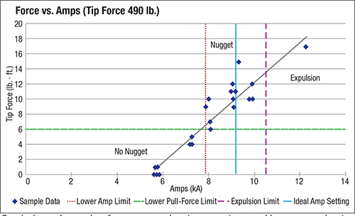

Force vs. Amps (Tip Force 490 lb.)
Graph shows the results of a process study using a consistent weld pressure and various weld currents to find the optimum current setting.
At this point, Sonnenberg and his associates at HTT put in the extra effort to ensure long-term resistance-welding success. He educated himself on the resistance-welding process and learned how to use all aspects of the control.
Also, he performed a process study using a consistent weld pressure and various weld currents to find the optimum current setting (see Force vs. Amps graph).

After installing the new control and performing the process study, HTT finally started to obtain consistent results, enabling Sonnenberg to review data from the weld log for any variations in the process that might cause quality issues.

A third-shift operator reported another potential issue, a popping noise coming from the weld area, accompanied by a low-current error on the control. However, by the time the first shift arrived, everything was back to normal.
