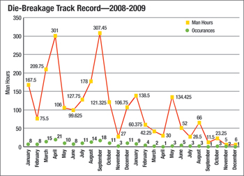

Productivity Clairon's in-die sensing program
Clairon’s in-die sensing program, ramped up since it installed new controls on its 10 hardest-working presses, slashed die-repair costs from $69,000 in 2008 to $28,000 in 2009, and this the firm expects that figure to drop all the to under $5000

“Most of our dies have at least five or six sensors,” he says. “Die crashes are down, to a maximum of one or two per month, a huge improvement from the double-digit monthly die crashes the firm once endures. “And now when a press stops, everything else stops as well,” says Butler. “Not so long ago we were averaging 40 man-hr./day for die maintenance; that’s now down to just 5 hr./day.”
