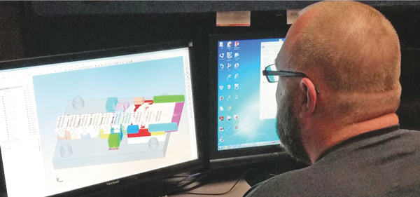

Jamesway die designer Mark Gortsema uses Cimatron software to design dies in 3D. “Cimatron doesn’t care if part files are full solids or not,” he says. “At the end of the day, I just need to machine the blocks to get them into the wire-EDM machine. Cimatron gets us there more quickly, allowing us to repair solid files efficiently by healing and stitching data where necessary.” Here, Mark reviews the bottom half of a die, with the die drawn in 3d so he quickly can spot any interference of die components.
“Cimatron doesn’t care if part files are full solids or not,” says Gortsema. “At the end of the day, I just need to machine the blocks to get them to the diemakers. Cimatron gets us there more quickly, allowing us to repair solid files efficiently by healing and stitching data where necessary. And, the ability to work with non-stitched models and poor-quality imported data is huge from a profitability standpoint.
“For example,” Gortsema continues, “if there’s a 0.005-in. gap between die faces, I can still get the job into the CNC machine and make good parts. That’s the bottom line, and what matters most.”

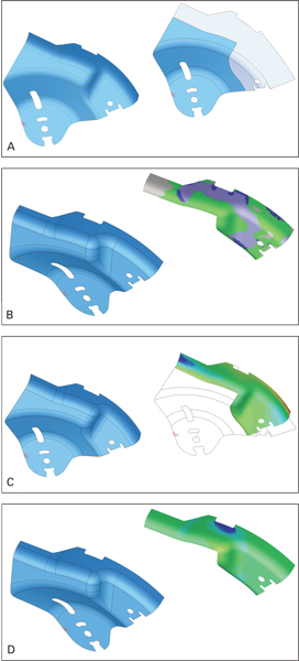

The optional Blank on Binder module used at Jamesway supports the creation of intermediate binder blanking surfaces, and unfolds the part on these faces. As displayed in this sequence of images from Cimatron, note how (A) the module calculates the part against the binder to see, in a multi-hit operation, what a second hit would look like; illustrates (B) a safety zone, where the part will have wrinkles or tears; shows (C) how the sheetmetal will spring away from the form; and determines (D) how much the material will thin or thicken.

Also for design of these parts, one of the optional modules Cimatron provides paid measurable dividends—it’s called Blank on Binder. According to Cimatron, the Blank on Binder module, based on finite-element analysis, allows users to unfold freeform shapes onto a 3D geometry quickly and accurately. It supports the creation of intermediate binder blanking surfaces, and unfolds the part on these faces, avoiding a time-consuming and costly trial-and-error process.
“We used the Blank on Binder module on a six-month trial basis,” says Gortsema, “and found it to be very useful on several projects, including unfolding the complex multifaceted forms on the seat parts. We’ll likely purchase the module soon.”
