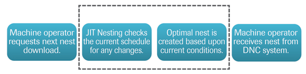

JIT nesting strategies work with a single machine or multiple machines. The machine operators run the system just like they interface with a typical DNC system that downloads the next program to run. The machine operator does not do the nesting; nesting occurs automatically. When the machine operator requests the next nest, the expert system checks the schedule, and then creates an optimal nest for the target machine. The completed nest then routes to the DNC system and is passed to the machine. Alternatively, for machines on the network, the program can be placed directly on the machine control.

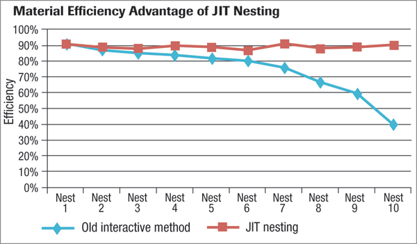

Why does material efficiency rise? Since manual nesting is time consuming, multiple nests must be prepared in advance of being run on the machine. These nests typically are created from a fixed set of parts known to be needed at the time the nests are created. While the initial nests will make efficient use of materials, as nesting continues the number of parts left to nest becomes fewer, and so the nests become less efficient. This is called tail-off (Fig. 1 below).
JIT nesting avoids tail-off because the process never runs out of parts. New orders als are occurring as prior orders are being completed. JIT nesting blends the end of one set of requirements with the beginning of the next set of requirements, generating huge material savings (Fig. 2 above).

Fig. 1—Because manual nesting is time consuming, multiple nests must be prepared in advance of being run on the machine. While the initial nests may be efficient, as nesting continues the number of parts left to nest are fewer, and the nests become less efficient. This is called tail-off. |

Fig. 2—With JIT nesting, tail-off never occurs. New orders are als occurring as prior orders are being completed. |

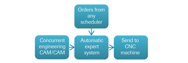

This method of nesting, called JIT kit nesting, processes each order as a kit of parts that must be fabricated together and flow together through the facility. The flow diagram looks like this:
