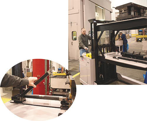

“QDC did not come easily with the Minster press,” shares Gray. “While another facility might have added on to make room for this new press, we did not have that luxury. So we squeezed it into an area inaccessible by a tow motor.”
Gray demonstrates the tight turning radius of the Rico die cart, allowing it to access the firm’s new 160-ton Minster high-speed press (background). The cart is outfitted with a pair of hooked arms (left) that wrap around steel loops LuK bolted to 150 of its dies. LuK also uses the cart to changeover the Bruderer press, which has shaved at least 2 min. from its changeover times compared to using a tow motor.
How, then, does the Minster press operator change-out his dies? “We went to die-cart manufacturer Rico Equipment (in nearby Medina, OH) to develop a custom solution for us,” Gray shares. The resulting cart is a Rico Model R-DHFP-2T-60 two-tier 6000-lb.-capacity die handler outfitted with a pair of hooked arms that wrap around steel loops LuK bolted to some 150 of its dies. The cart features two horizontal tables on one carriage, allowing die transfer and storage to be performed in one docking operation.
Rico literature notes that its die handlers are designed to operate in less area than conventional forklift trucks, due to their tight turning radius. This allows less space between presses and minimizes wasted aisle space.

LuK not only employs the Rico die cart to perform die changes on the Minster press, but also uses the cart to changeover the Bruderer press, in place of a tow motor.
“On the Bruderer, the cart has shaved at least 2 min. from our changeover times,” Gray says. “And, considering the delicate, critical nature of some of our high-speed dies and the relative cost of those dies compared to the dies used to stamp clutch components, we’re much more comfortable handling those dies with the die cart rather than the tow motor.”

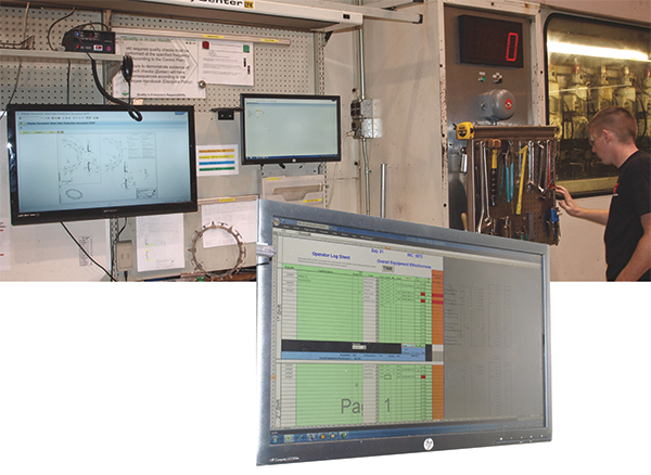

The use of the die cart, and the need to carefully schedule its use so that it’s available when the Minster and Bruderer need it, is indicative of the overall sense of urgency evident in the LuK pressroom. Press operators are responsible for attaining established OEE goals.
As such, LuK’s press operators have engineered several Kaizen events to help quicken the pace at which materials move through the shop. One example we spied: each press line includes a set of three signposts used to signal to the pressroom team the status of the line. Green signs indicate the presence in the press cell of the blanking and forming dies and coils needed for the next job scheduled to run; a red sign means something’s missing in order for the next job to run. As we toured the pressroom, all we saw were green signs—excellence in action.
“This is just one of many action items initiated from ideas provided by our crew,” says Gray, “that add up to squeezing as much productivity and throughput we possibly can from our existing press capacity.
