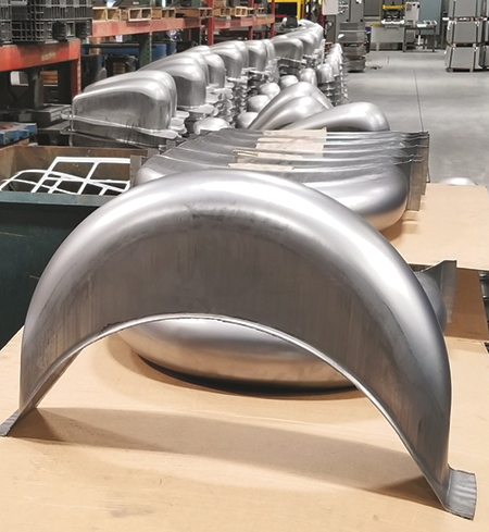

This fender, along with fuel-tank-shell halves stacked to the left, are formed on a new hydraulic press. Envision Engineering draws parts to as deep as 13 in.

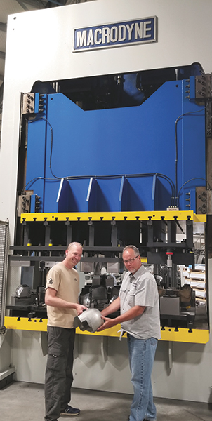

“We were worried about our older presses breaking down and we could not afford downtime, so we began looking at new presses,” Roerig recalls. “Four years ago, we purchased a new Macrodyne 500-ton hydraulic press. Because it would be built nearby (in Concord, Ontario, Canada), we were comfortable with our selection, and Macrodyne has followed through with collaboration and customer service to ensure that the press could do what we needed it to do.”
Adds VanderWilp: “We can program the 500-ton press for needed tonnage and store recipes, and receive feedback from the press as to tonnage and shut-height needs based on the tooling. It is a huge upgrade to our older presses and is extremely safe to operate. The same holds true for the current 400-ton press and the 500-ton press to be installed later this year.”
The new deep-draw presses at Envision Engineering provide optimal control of force distribution and material flow, resulting in structurally superior finished parts while eliminating wrinkling or tearing of the material, according to Macrodyne officials.
Envision Engineering stamps mild and stainless steels as well as aluminum alloys in thicknesses to 1⁄8 in., according to Pat McGill, general manager. Annual volumes run the gamut from 100 to 80,000 parts, with runs to 50,000 parts identified as the company’s forte, according to Roerig.
Some draws at Envision Engineering reach 13 in., according to VanderWilp, and the 500-ton Macrodyne press can produce a flawless drawn part in less than 60 sec. For shallow draws or forms, it can deliver as many as 20 parts/min. Again, tonnage control combined with recipe storage enables precise press tuning across the variety of parts produced.
