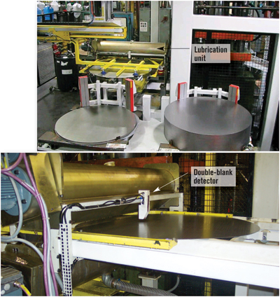

The three-axis press robot (top) stationed at the 300-ton deep-draw press cell takes a 39.5-in.-dia. blank from the palletized stack and prepares to drop it into a centering station. The blank then moves, via a single-axis programmable shuttle (bottom), through a noncontact lubrication system and then is picked up again by the robot for loading into the press. Note the double-blank detector at the entry end of the lubrication unit.

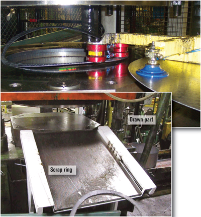

The press robot’s end-of-arm tooling (top) features a pair of end effectors—suction cups to manipulate the blank and magnets to remove the scrap ring from the previous press stroke. As the robot deposits the scrap ring onto a conveyor it drops the blank onto the die. Finished, drawn parts can be seen (bottom) exiting the press on a conveyor.
During production, as the punch descends it pinch-trims between the cutter and the die ring. The drawn dome leaves the press trimmed and the scrap ring remains on top of the die. Amtrol then performs a beading operation on the edge of the dome, and also uses the trimmed edge to track the weld joint during assembly.

To automatically handle blanks from stack to rack, Weston and his team at Amtrol invested in an automation system designed and built by AP&T North America, Inc., Monroe, NC. Included is an AP&T SpeedFeeder 60 three-axis press robot; two floor-mounted blank-storage magazines, each with a maximum stack height of 15.75 in. and four fixed permanent magnets used to separate the blanks; and a single-axis programmable blank feeder with double-blank detector, which shuttles blanks into a new noncontact lubrication unit.
The SpeedFeeder 60 lifts blanks from the stack and deposits them onto the blank feeder for loading into the lubrication unit. The SpeedFeeder then picks up the lubricated blanks at the opposite end of the lubrication unit and loads them into the die. It carries a unique double end-of-arm tool designed to simultaneously carry the scrap ring off of the die and deposit it onto a scrap conveyor while at the same time depositing the lubricated blank onto the die. Magnetic lifters handle the scrap ring as suction cups grip the blank. Finished, drawn domes drop below the press bed onto conveyors for transport to downstream operations.
“Ensuring that we have removed the scrap ring from atop the die was a critical requirement in automating the process,” shares Weston. The firm at first tried a single sensor to indicate to the press control when the scrap ring had safely exited the die. However, it quickly found a more reliable solution when it installed a full light curtain at the entry end of the scrap conveyor so that, regardless of where and how the end-of-arm robotic tool deposits the ring onto the conveyor, the light curtain senses its presence and then signals the press control to allow the press to stroke.
