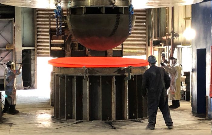

“Hot forming a head in the new press, as well as in our existing modified 1500-ton press,” Harrison explains, “we heat the circular steel blank in one of our furnaces to about 1670 F, which can take as long as 6 hr. depending on steel thickness, and then move it over to the press and into the die to form it through a ring. We have 3 min. to complete the forming process. Formed sections then move to one of our two robotic-cutting rooms for edge-beveling, trimming and hole cutting using either the plasma or oxyfuel process.”

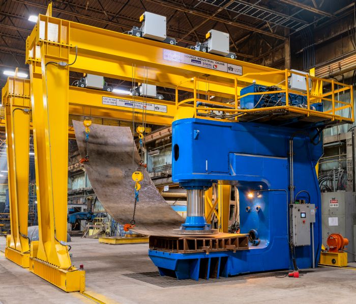

The third partner in the NGen grant (a total of $8 million between the three partners), Source Industrial Services Inc., provided state-of-the-art gantry cranes positioned on both sides of Conrex’s repurposed C-press to manipulate the huge and heavy steel blanks for forming sphere components. “The cranes are controlled in synch with the press-ram motion,” Harrison notes, “indexing the material left and right and front and back in tiny increments as the ram forms the steel. It’s a one-person operation, while most other shops would require two or three people to handle the same process.

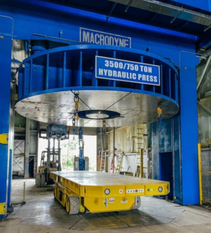

Photo D robot room robotic cutting“One of the goals of the Advanced Manufacturing Supercluster is to help companies compete globally,” Harrison adds, “by improving efficiency, and the automated crane motion certainly helps with that. In addition, Source Industrial helped us source an electronic, solar-powered, hydraulically driven transfer cart (120,000-lb. load capacity) that we use to move steel around the facility and dies in and out of the press. It has proven to be a very cost-effective way to increase our material-handling capacity without adding huge cranes to the facility.”
At press time, Conrex was wrapping up testing all 15 dies it built for the new press, some weighing as much as 50,000 lb., designed for different shapes of heads (hemispherical and semi-hemispherical) and plate thickness. It built the dies inhouse, while working with local machine shops for fine-tuned specially hardened components.
