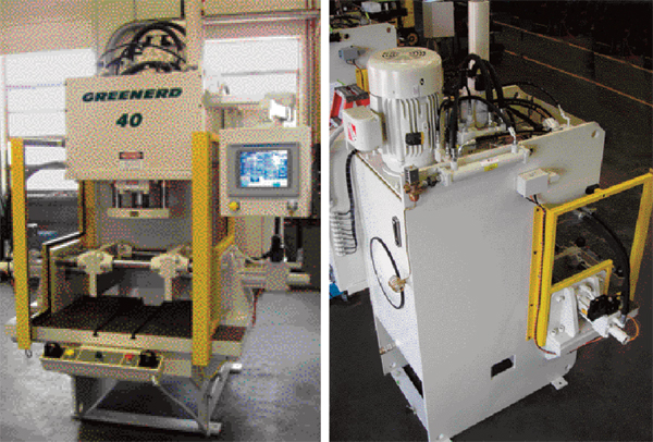

Hydraulic presses purchased as recently as 10 to 15 years ago likely employ outdated technology that restricts cycle times and can cause inconsistent part runs. They also may include a manual proximity switch to signal positioning on reversal, only as accurate as your hand is steady.
To reduce cycle times and improve part quality, better valves and high-performance PLCs provide faster speeds and excellent positional accuracies. Servo-quality proportional valves offer fast response times, even in larger-size valves that can handle the required flow and faster cycle times. Proportional valves offer an improved level of control over older servo valves, without the sensitivity to contamination that can lead to maintenance issues. And, today’s PLCs have scan times fast enough to achieve ±0.001-in. positional accuracy with a D08-size valve, and provide monitoring of the linear transducer to achieve the reversal/positional accuracy of the press. The controller’s high-speed ramping functions provide the ability to manage the increased pressing speed.
Using today’s valves and PLCs, cycle times can be improved with simpler and easier-to-troubleshoot circuits. Variable-displacement piston pumps allow flow and pressure to be controlled directly at the pump, simplifying the hydraulic circuit and optimizing horsepower to improve the circuit’s efficiency. As efficiency increases, wear on the oil and hydraulic components is reduced, which in turn reduces the maintenance burden.

To reduce cycle times and improve part quality, a press rebuild includes installing servo-quality proportional valves and high-performance PLCs to offer faster response times and improved positional accuracies. Other rebuild services include replacing or rebuilding pumps and motors, rewiring electrical systems, rebuilding cylinders and replacing worn platen guides/slides.
Using touchscreen press controls, all press-setup points—including those for top stop, slowdown and reversal—can easily be changed. This eliminates the need for time-consuming manual adjustments. This “closed-loop” system is als adjusting itself against stored parameters. A control’s artificial intelligence can even reject incorrect settings, preventing costly accidents. In addition, ram position is tracked by a linear transducer, which rarely needs calibrating. The control can be integrated with a precision digital control system, which enables actual position accuracies of ±0.001 in., and reversal at ±one percent of specified tonnage.

For a look at the benefits that come from a complete press rebuild, consider an automotive customer operating a 1997-vintage gap-frame press. The company recently required an upgrade to make the press ANSI-compliant, while providing all of the quality, flexibility and maintenance advantages of today’s technology. Greenerd replaced all of the hydraulics and electrical components to a modern PLC, ANSI-compliant configuration. The only elements remaining intact were the frame and steel components, which will last indefinitely.
A significant benefit was derived from synchronizing the two auxiliary side cylinders on the press. A master slave control on both sides uses servo-quality proportional direction valves mounted directly to each cylinder to achieve 0.001-in. position tolerance. Prior to this rebuild, the customer was using hardened stop blocks to hit the hard stop. This older process is prone to error because after the press cycles, the parts may move out of tolerance, requiring manual repositioning of the blocks. MF
